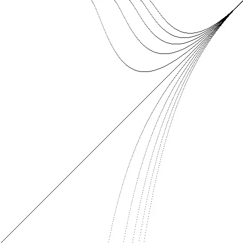

Here are some numerical results obtained using Runge-Kutta integration from $x=1$ to $x=0$ for various values of $y''(1)$ equally spaced between $-2$ and $2$:
Runge-Kutta results
Here’s the Java code I used.
Note that $y=x$ is a solution (which is clear when you multiply the differential equation by $1-y'$).
If you want the curve that starts at a given point $(x_0,y_0)$, you can integrate from $(1,1)$ with some value of $y''(1)$ and then adjust this value until you hit the desired origin.

    Thank you, that was most helpful! I should say, that I did run numerics for a discrete version of this problem (that is, I have a cost function between points on a grid, and I perform a search to minimize the sum), and I get trajectories that look (at least qualitatively) very similar to your numerical integration. – info_theorist Mar 14 '24 at 14:54
