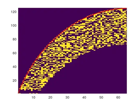

Here is a visualization of what I am trying to do. Y axis is the number $a$ as a binary number. Yellow means set bit (digit 1), blue means unset bit (digit 0). The red curve is the model. It is fit with regression using a polynomial model against the uppermost yellow a for every b. It should roughly be the same as a polynomial fit against 2-logarithm of $nCr(a,b)$.
The goal is to as closely as possible capture how many bits are required for each value of nCr.
Edit the lower portions of zeroes in the graph seem to be a numerical error due to me using floating point arithmetics and poor choice of calculations.

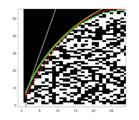

In this answer the proposed method will save all the area above the gray line. While we can see that it will save a lot less bits than other approaches closer to the most significant bits, we will avoid having to make involving calculations in keeping track of where the bits are, they will follow a simple linear function which also is easy to index for a bit writer and reader.
