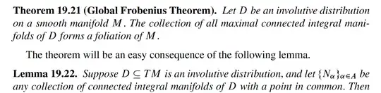

Hereafter is an excerpt from Introduction to Smooth Manifold by John Lee. The last line is where I'm lost.
enter image description here page 503

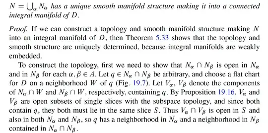

Essentially, $D$ is an involutive (smooth) distribution of rank $k$ on a (smooth) manifold $\mathcal M$ of dimension $m$, $\mathcal N_1$ and $\mathcal N_2$ are integral manifolds for $D$, with $\emptyset\ne\mathcal N_1 \cap \mathcal N_2$, and we want to show that $\mathcal N_1 \cap \mathcal N_2$ is open with respect to, say, $\mathcal N_1$ (whose topology may be finer than the subspace topology induced by $\mathcal M$).
To this end, let $q\in \mathcal N_1 \cap \mathcal N_2$, and let us consider a chart $(W,\varphi)$ of $\mathcal M$ in $q$ that is flat for $D$ – this means just that $\varphi(W)$ is a cube in $\mathbb R^m$, and that $\partial/\partial x^1,\dots,\partial/\partial x^k$ is a (local) frame for $D$ over $W$. We call $V_i$ ($i=1,2$) the connected component (I guess with respect to the topology of $\mathcal N_i$) of $\mathcal N_i \cap W$ containing $q$. From previous results, we know that our $V_i$'s are open sets of the same slice $S=\{p\in W \,\vert\, \varphi^{k+1}(p)=c^{k+1},\dots,\varphi^{m}(p)=c^{m}\}$ of $W$, therefore $V_1\cap V_2$ is open in $S$ with respect to the subspace topology.
Here, as far as I understand, Lee is saying: since $V_1\cap V_2$ is open in $S$, then it is open in $\mathcal N_1$. What is the line of reasoning one should be following?
PS: my sketch argument would be along the following lines. Since $V_1$ is a connected component of $\mathcal N_1\cap W$, it should be open in $\mathcal N_1$. Also, for a subset of $V_1$, being open in $V_1$, or in $\mathcal N_1$ should be the same. From the fact that $V_1\cap V_2$ is open in $S$, we have $V_1\cap V_2= G\cap S$, for some open set $G$ of $\mathcal M$. Then $V_1\cap V_2= G\cap V_1$, hence is open in the subspace topology induced by $\mathcal M$, hence in $V_1$, hence in $\mathcal N_1$. But this seems to be too convoluted, I feel like I'm missing some very basic stuff.

It's been a while since you have asked the question, but for the sake of an answer, note that the required result is mentioned in the referenced Proposition 19.16 of the book: "each slice is open in the integral integral submanifold containing it and is embedded in $M$." First couple of lines of the argument in that proposition is used here: Let $\iota:N_\alpha \to M$ be the embedding of $N_\alpha$ in $M$. Then $W$ is open in $M$ and so $\iota^{-1}(W)=W\cap N_\alpha$ is open in $N_\alpha$. And $S$ is a connected component of this subset $W\cap N_\alpha$ open in $N_\alpha$, so $S$ is itself open in $N_\alpha$.
So when here it is proved that $V_1 \cap V_2$ is open in $S$, as $S$ is also open in $N_\alpha$ (and in $N_\beta$), we have $V_1\cap V_2$ is open in $N_\alpha$ (and $N_\beta$).
