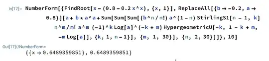

Using Lagrange reversion: $$x=a+bx^x\implies x=a+\sum_{n=1}^\infty\frac{b^n}{n!}\frac{d^{n-1}}{da^{n-1}}a^{na}$$ Now use a Stirling number of the first kind formula, possible to derive from this pattern $$\frac{d^n}{dx^n}f(\ln(x))=x^{-n}\sum_{k=1}^n S_n^{(k)}f^{(k)}(\ln(x)):\frac{d^{n-1}}{da^{n-1}}a^{na}=a^{-n}\sum_{k=1}^{n-1}S_{n-1}^{(k)}\left.\frac{d^k}{dt^k}e^{n t e^t}\right|_{\ln(a)},n>1$$ Also, the $n=1$ term is extracted out. Finally, use $e^x$’s Maclaurin series and general Leibniz rule $$\left.\frac{d^k}{dt^k}e^{n t e^t}\right|_{\ln(a)}=\sum_{m=0}^\infty\frac{n^m}{m!}\left.\frac{d^k}{dt^k}t^me^{mt}\right|_{\ln(a)}=\sum_{j=0}^k\binom kj\left.\frac{d^j}{dt^j}t^m\right|_{\ln(a)} \left.\frac{d^{k-j}}{dt^{k-j}}e^{tm}\right|_{\ln(a)}$$ summing over $j$ gives a Tricomi confluent hypergeometric function: $$x=a+bx^x\implies x=a+ba^a+\sum_{n=2}^\infty\sum_{m=1}^\infty\sum_{k=1}^{n-1}\frac{(-1)^kb^nn^m\ln^{m-k}(a)a^{m-n+1}S_{n-1}^{(k)}}{m!n!}\operatorname U(-k,m-k+1,-mt)$$
shown here:

Both series work for $a,b\in\Bbb C$. For certain values, like small $|b|,|a|$, the series converges fine. However, for values outside these, the series converge more slowly, like for the asker’s example.
