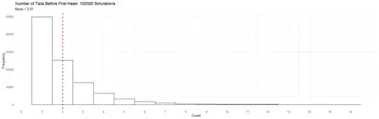

I then wrote this simulation in R to confirm the results (i.e. coin flipping simulations):
   flip_until_head <- function() {
    count = 1
    while(sample(c("H", "T"), 1) == "T") {
        count = count + 1
    return(count)
results <- replicate(100000, flip_until_head())
mean_count <- mean(results)
ggplot(data.frame(results), aes(x=results)) + geom_histogram(binwidth=1, color="black", fill="white") + geom_vline(aes(xintercept=mean_count), color="red", linetype="dotted", size=1.5) + labs(title="Number of Tails Before First Head: 100000 Simulations", subtitle=paste("Mean =", round(mean_count, 2)), x="Count", y="Frequency") + scale_x_continuous(breaks = 0:max(results)) + theme_minimal()

  • Through Markov Chains and the Geometric Distribution it is unreasonable to believe that the game being played within the St Petersburg Paradox will last forever. There is a finite time to absorption (i.e. end of game).
  • Since there is a finite number of turns in which the game is expected to end, there is a finite reward in this game
  • Therefore, from the perspective of Absorbing Markov Chains, it appears that the St Petersburg Paradox is not really a paradox : It is a game with finite duration and finite reward.
  • But from the perspective of the classical expectation analysis, the game will have an infinite reward
Is this analysis correct?

I think the final interpretation you have given of the math you have done is not correct, which is not to say there's anything wrong with the code or calculations. The expectation of earnings in the St. Petersburg "paradox" is infinite (as the original analysis proves) even though the expected number of flips is finite. That is not a contradiction.
There is no way to use some new mathematical technology or language to disprove that the expectation is infinite, so nothing is resolved.
In my opinion there is nothing paradoxical in the St. Petersburg paradox to resolve in the first place. It just goes to show that in risk analysis, knowing the expectation of a distribution is insufficient for rational decision-making.
