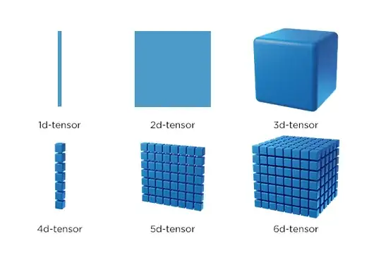

15
If your friend is a computer scientist, then he should be well acquainted with the concept of scalars, vectors, and matrices. I see a tensor as a generalization of scalars, vectors, and matrices to higher dimensions. In other words, a tensor is a multi-dimensional array.
A scalar is a single number. You can view a scalar as a special case of a vector, that is, a vector with a single dimension of size $1$. So, a vector is a generalization of a scalar.
A vector is an ordered collection of numbers in a single dimension. You can view a vector as a special case of a matrix, that is, a matrix with a single dimension of any size $n \ge 1$. So, a matrix is a generalization of a vector.
But a matrix is an array restricted to two dimensions, each with its own size. A tensor extends the notion of a matrix analogous to how a vector extends the notion of a scalar and a matrix extends the notion of a vector. A tensor can have any number of dimensions, each with its own size. A $3$-dimensional tensor can be visualized as a stack of matrices, or a cuboid of numbers having any width, length, and height. A $4$-dimensional tensor can be visualized as a sequence of cuboids, each having a fixed width, length, and height. A $5$-dimensional tensor can be visiualized as a matrix in which every entry is a cuboid, and so on. I think the below image is a nice summary...
Notice a $1$-dimensional tensor is the familiar vector, and a $2$-dimensional tensor is the familiar matrix.
Finally, in the same way scalars, vectors, and matrices can be multiplied by one another to map objects between vector spaces (or to map objects in the same vector space), multiplication with a tensor is no different. There are additional nuances and ideas related to the use and functionality of tensors (see response of WimC for a concise summary), but I think the explanation I provided will get your friend off to a good start.
    While this is fine as far as it goes, I suspect OP is trying to convey more about tensors than their basic shape. If the CS student asked "What distinguishes a tensor from just a multi-dimensional block of numbers?" what would you answer, I wonder? – Brian Tung Feb 11 '24 at 21:12
    I didn't get the impression OP wanted a comprehensive and detailed explanation of tensors. It seems he was trying to give a more intuitive description. For instance, he described a tensor as an $n$-d array just as I did, but with no success. If his friend cannot grasp that, then I doubt he will grasp anything more complex. That is why I thought better to reinforce and focus on its description as an $n$-d array instead of going into the weeds. To answer your question, I would need more room than is available in the comments. I suggest you post your question to the SE. – RyRy the Fly Guy Feb 11 '24 at 21:48
    @BrianTung At that point, I would politely point the CS student to the nearest comprehensive PDF manual of the APL programming language. APL is what made tensors really "click" for me. Most of the interesting tensor operations are just built-ins in the array programming world. – Silvio Mayolo Feb 13 '24 at 04:14
