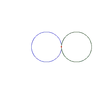

Consider the Cardioid, which is drawn (in red) like this ...
(Image credit: Wojciech Swiderski via Wikipedia)
... according to these parametric equations: $$\begin{align} x &= 2 \cos t - \cos 2 t \\ y &= 2 \sin t - \sin 2 t \end{align}$$
The cardioid curve happens to contain all (and only) the points satisfying this relation: $$\left( x^2 + y^2 - 1 \right)^2 = 4 \left((x-1)^2 + y^2 \right)$$ but really ... how helpful is that to understanding the curve?
