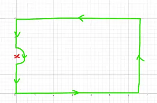

When we see an integrand such as $\frac1{1+e^{ax}}$ with the objective of contour integrating, we should immediately think "rectangular contour", as the poles are along the imaginary axis. However, we cannot directly take the integrand as our complex function, as on a rectangular contour, the top and bottom contours will cancel out without a proper numerator (try it if you dont believe me lol)
Instead, let's try the function $\displaystyle f(z)=\frac{e^{bz}}{1+e^{az}}$ where $b=0$ in $$J(b)=\int_0^\infty \frac{e^{bx}}{1+e^{ax}}\text{ d}x$$ will give us our desired integral $J(0)=I$.
Consider the contour below, where the pole shown is at some $\pi i\over a$. The rectangular contour goes from the origin to $z=R$, then up to $z=R+\frac{2\pi i}{a}$, then left to $z=\frac{2\pi i}{a}$, down to $z=\frac{\pi i}{a}+\varepsilon$, around in a small arc of radius $\varepsilon$ to avoid the pole, and then back down to the origin.
(I'm assuming you have some experience with contour integrals, so I'll skip the parameterization, DCT limit passing arguments, etc)
The bottom path reduces to $J(b)$, the right path goes to $0$, the top path gives us a $-e^{\frac{2\pi ib}{a}}$ multiple of $J(b)$, and the small arc gives $\frac{\pi i}{a}e^{\frac{\pi i b}{a}}$ after using DCT to pass the limit. However, the straight left-side paths gives us the principal value integral $$PV\int_\frac{2\pi}{a}^0 \frac{ie^{biy}\text{ d}y}{1+e^{aiy}}$$ after taking the $\varepsilon$ limit.
Solving this integral utilizes techniques such as hypergeometric function/series, and we cannot avoid this by taking real or imaginary parts either since the numerator isn't nice. This defeats the purpose of contour integration.

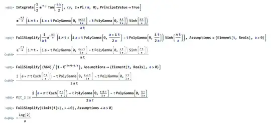

As it turns out, if we pass the imaginary part over it, the integrand of the principal value integral actually cancels out into a very nice $e^{-ty}\over 2$. HOWEVER, the imaginary part also reduces $K(t)$ down to $$\Im K(t) = \int_0^\infty {\sin(tx)\over 1+e^{ax}} \text{ d}x$$ for which $t=0$ does not work, since it gives the numerator a value of $0$ instead of the desired $1$. This is not what we want.
We can pass the real part function instead, and get a cosine on $K(t)$, which does reduce the numerator of the integrand down to 1 when $t=0$, $$\Re K(t) = \int_0^\infty {\cos(tx)\over 1+e^{ax}} \text{ d}x \iff \Re K(0) = I$$ However, this also reduces the principal value integral's integrand to $\frac12 e^{-ty}\tan(ay/2)$, which decidedly does not integrate well, so this defeats the purpose of contour integration. You can hard bash the result, but really, is this what you're aiming for?
Probably not.
(also idk where that negative came from, probably some small algebra error i couldnt catch earlier but w/e im not running the principal value again it took so long lol)

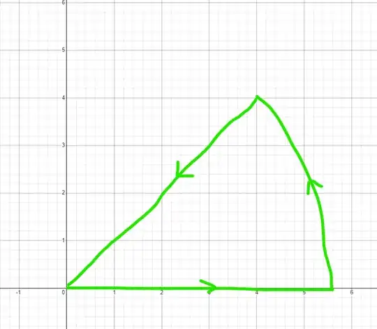

Lastly, just for the sake of it, you could directly use the function $\displaystyle f(z) = \frac1{1+e^{az}}$ with the contour
to directly get a result in terms of $I$ by avoiding the two cancelling rectangular paths. This contour here is a pizza slice of 45 degrees, going from the origin to $z=R$, then in a 45 degree arc counterclockwise, and then back to the origin. This contour avoids dealing with any of the pole or principal value shenanigans at all, by staying away from the imaginary axis.
Here, the outer arc goes $0$, and the bottom path gives our integral.
(verifying the outer arc does indeed go to 0 can be done manually when we pass the limit inside using DCT of couse, but I used mathematica, which gave a funny seemingly nonsense restriction shown below)
The remaining diagonal path then gives us the integral $$\int_\infty^0 \frac{e^{\pi i\over4}\text{ d}r}{1+e^{are^{i\pi\over4}}}$$ but to evaluate this, we legit have to use the same substitution/tricks we would have done if we evaluated our original integral $I$ directly, so this defeats the purpose.
