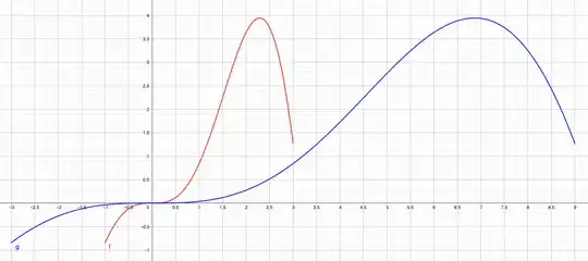

I am not going to prove this here, but it is something which is relatively easy to see and build some intuition for using a tool like GeoGebra. For example, in the following image, the function $f$ (in blue) is defined on the interval $[-1,3]$, while the function $g$ (in red) is a scaled copy of $f$, defined by the formula $g(x) = f(x/3)$.
If the integral is interpreted as the area under the curve, then this model makes it more clear that the area under $g$ is exactly $C$ times the area under $f$—horizontally scaling the graph of $f$ by a factor of $C$ scales the area by that same factor. This implies that $$\int_{a}^{b} f(x)\,\mathrm{d}x = C \int_{Ca}^{Cb} f\left( \frac{1}{C} x\right) \,\mathrm{d}x. $$
