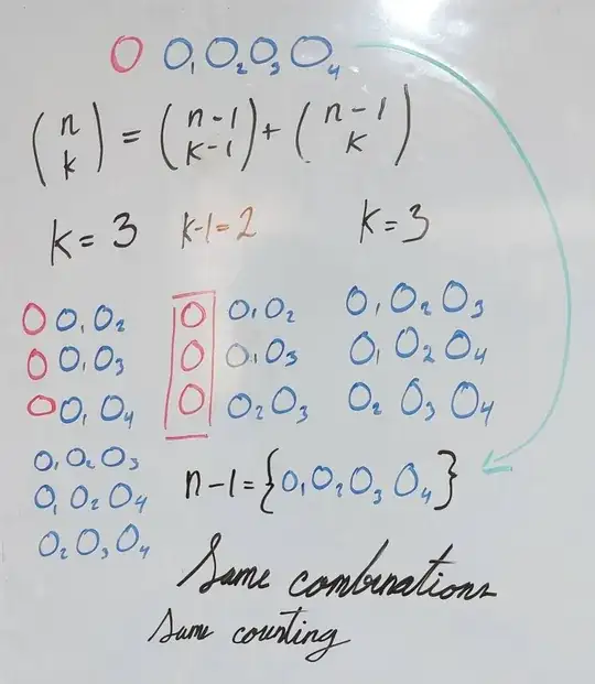

The problem becomes more comprehensible with the aid of an illustration. Consider an image featuring 5 balls, 4 of which are blue and 1 is red. Enumerating all possible combinations visually elucidates the scenario.
