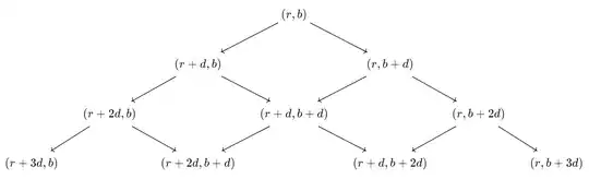

Here's a counterexample: consider a coin which flips heads or tails fairly until it flips two heads (tails) in a row, following which it will always flip heads (tails). By symmetry, one can conclude that $P(H_n) = \frac{1}{2}$. Indeed, we also have $P(H_2 \mid H_1) = P(H_1 \mid H_2) = \frac{1}{2}$ since the first two flips cannot influence each other. However, $P(H_3 \mid H_1 \cap H_2) = 1$ and $P(H_1 \mid H_2 \cap H_3) < 1$ since the flips $THH\cdots$ are certainly possible. That being said, Polya's urn has something more special. One way to argue this is somewhat categorically: enter image description here Each arrow has a certain probability. The important detail is that each square "commutes" in the sense that if you compose the two arrows on the left, you get the same probability as composing the two arrows on the right. This immediately tells you (this is an exercise in induction) that the whole diagram "commutes" in the sense that all possible route from one vertex in the tree to a descendant has the same probability.
How do we get what we want from here? Well, we can first prove that $P(B_{i_1} \cap B_{i_2} \cap \cdots \cap B_{i_n})$ is independent of the pairwise distinct $i_k$ (but dependent on $n$ itself). Consider some other choices of pairwise distinct $j_1, j_2, \ldots, j_n$ and let $N > \max(\{i_k : 1 \leqslant k \leqslant n\} \cup \{j_k : 1 \leqslant k \leqslant n\})$. Look at the two events in the set of all possible routes of size $N$ from the root.
In the event $B_{i_1} \cap \cdots \cap B_{i_n}$, we impose blue on steps $i_k$, but the other steps are free to be either red or blue, and similarly for the other event. However, it is clear that the number of possibilities with a fixed number of reds are equal for both events since we don't care about which steps are imposed to be blue. But this immediately tells us that the probabilities are the same since our diagram tells us that the probability of any route only depends on the number of reds and blues. Now, what you want follows immediately since: $$P(B_{i_1} \mid B_{i_2} \cap \cdots \cap B_{i_{n+1}}) = \frac{P(B_{i_1} \cap B_{i_2} \cap \cdots \cap B_{i_{n+1}})}{P(B_{i_2} \cap \cdots \cap B_{i_{n+1}})}$$

    I like the "somewhat categorical" approach. But I don't understand the details in the last paragraph. You never use the variable $N$ that you introduce, and it's not clear to me what possibilities "the number of possibilities" refers to – presumably that set of possibilities has to do with $N$? – joriki Jan 16 '24 at 07:10
    Whoops, I forgot to add an important sentence in the middle! Thank you so much. Does it make sense now? – Haran Jan 16 '24 at 07:17
    It does, thanks! – joriki Jan 16 '24 at 07:23
  • Thank you. Are you able to provide a bit more help on how you would prove how the diagram "commutes"? What exact mathematical statement would you be trying to prove? And how would you get started on the induction? I am new to all of this stuff, so am very rusty and struggling to get started in a lot of problems. I get lost from the second sentence in your last paragraph. – b.b.89 Jan 16 '24 at 11:17
  • I would be willing to clarify the details, but perhaps we should discuss this in a chatroom to avoid extended discussions in the comments. – Haran Jan 16 '24 at 23:06
