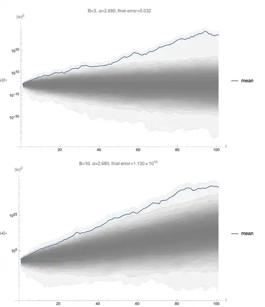

Solving for $a$ in $E[\log(1-a X^2)^2]=0$ gives the largest convergent learning rate for linear least squares mini-batch SGD with batch size $2b$, step size $a$ and observations $X$ distributed as standard normal in $d=1$ dimensions. Batch-size 1 case is also known as LMS filter. Stability of LMS filter w.r.t. to step size is not fully understood, so characterizing it completely for a simple case of Gaussian observations is interesting.
Related discussion here addresses the issue of convergence with batch size 1 and $d\ge 1$
Curiosuly, 1d iteration appears to become more unstable with increased batch size. In other words, applying random iteration several times and averaging updates at each step, can turn a stable random iteration into an unstable one.

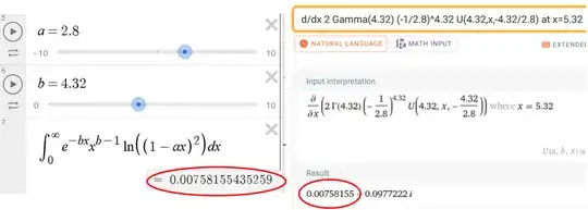

$$\bbox[15px,#E0EFFF,border:5px groove #0058B3]{\int_{0}^{\infty}e^{-bx}x^{b-1}\ln\left((1-ax)^{2}\right)dx=2\Gamma(b)\cdot \Re\left[\left(-\frac{1}{a}\right)^{b}U^{(0,1,0)}\left(b,b+1,-\frac{b}{a}\right)\right]}$$

Example with random numbers: $a=2.8$ and $b=4.32$

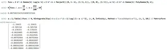

MMA code:
2 b^-b Gamma[b] Log[a/b] + 2 b^-b \[Pi] MeijerG[{{0, 1 - b}, {1/2, 1}}, {{0, 0}, {1/2}}, a/b] + 2 b^-b Gamma[b] PolyGamma[0, b]
MeijerG function can be expressed by hypergeometric function: $$G_{4,3}^{2,2}\left(\frac{a}{b}| \begin{array}{c} 0,1-b,\frac{1}{2},1 \\ 0,0,\frac{1}{2} \\ \end{array} \right)=-\frac{b \Gamma (-1+b) \, _3F_3\left(1,1,\frac{3}{2};2-b,\frac{3}{2},2;-\frac{b}{a}\right)}{a \pi }+\frac{\left(\frac{a}{b}\right)^{-b} \Gamma (1-b) \Gamma (b)^2 \, _3F_3\left(b,b,\frac{1}{2}+b;b,\frac{1}{2}+b,1+b;-\frac{b}{a}\right)}{\Gamma \left(\frac{1}{2}-b\right) \Gamma \left(\frac{1}{2}+b\right) \Gamma (1+b)}$$, but for: $b\in \mathbb{Z}$ is removable singularity
Numericall check: enter image description here

  • @Amir If I gives b=1 Mathematica say: Indeterminate expression,Maple gives: Error, (in GAMMA) numeric exception: division by zero.,you need use a Limit.Which is why MeijerG is better than Hypergeometric function. ` – Mariusz Iwaniuk Jan 20 '24 at 17:17
