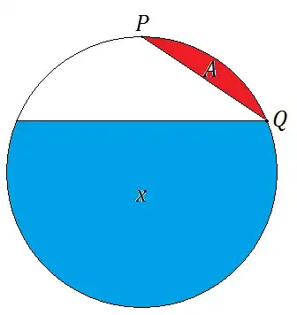

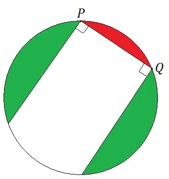

The first chosen point, $P$, is fixed. The second point chosen, $Q$, is variable. The triangle will not contain its circumcentre (i.e. will be obtuse) if and only if the third chosen point is in the red or green regions shown below (the diagram shows a sphere, not a circle).
Sphere1
Let $A$ be the area of the red region. Let $x$ be the area of the blue region shown below (the blue region's axis of symmetry goes through $P$).
Sphere2
Assume that the surface area of the sphere is $1$. It is easy to show that $A=\frac12(1-\sqrt x)$. So the probability that the third point lies in the red region is $\int_0^1A\mathrm dx=\frac16$. The red and each green region have the same areas averaged over $x$, so the probability that the third point lies in the red or green regions is $3\times\frac16=\frac12$.

    Thanks, this is great (and I like the colours :-). It's perhaps worthwhile to mention that the reason that the red and each green region have the same average area is that they each correspond to one of the three angles of the triangle being obtuse; and that (since the area of a slice of a sphere is proportional to its height) $2x-1$ is proportional to the $z$ coordinate of $Q$. – joriki Jan 12 '24 at 10:11
