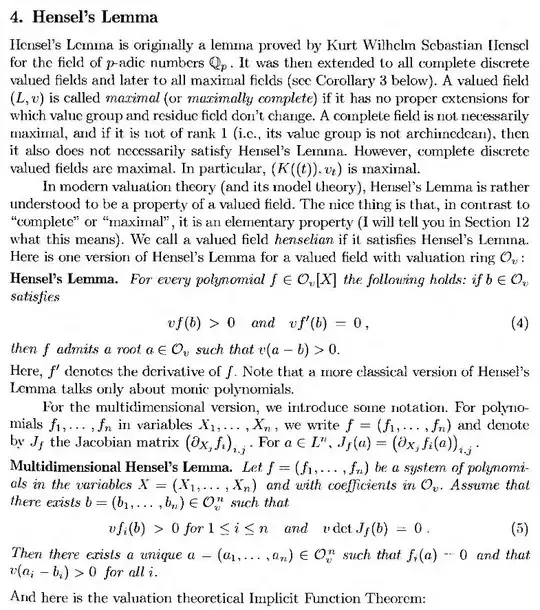

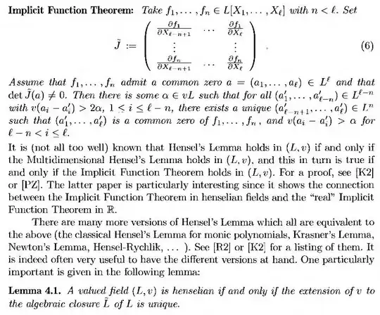

In the literature and on the web happened to me several times to read confused or simply cryptic assertions regarding the fact that Hensel's Lemma is the algebraic version of Implicit Function Theorem.
I tried to explicit this relation but I failed, here there are some observations I made.

Another observation is that Henselianity is exactly the condition needed for a local ring $R$ for having no non-trivial étale coverings of $\operatorname{Spec}(R)$ which are trivial on the closed point. Since these coverings are in correspondence with ètale algebras of $R$ I examined this direction and I found that, for any field $k$, the $k$-algebra of the form $k[x]/f(x)$ is ètale over $k$ if and only if $f'(x)$ is invertible in the algebra.
There is also a more complicated criterion for ètale algebras over rings which uses the invertibility of the determinant of the Jacobian of a system of polynomials. This is very reminiscent of the key condition of the Implicit Function Theorem, but I don't know why.
