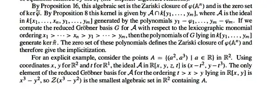

A similar computation is done here, but I don´t know exactly how they arrive at $x^3-y^2$ by the way of computing the reduced gröbner-basis, since this is not spelled out in detail:

As some of the comments pointed out, you can also approach this problem by "guessing" elements that cut out the image of $\varphi$. For $x=t^2$ and $y=t^3$, one relation that is true is that $x^3 = t^6 = y^2$, so $x^3-y^2 \in I(\{(a^2,a^3,a^4) \in \mathbb C^3\})$. One can keep guessing "true facts" about the Zariski closure, and then to show that your relations are sufficient you'll often have to do something with dimension or something about some sort of ad-hoc (as opposed to Grobner basis stuff) polynomial long division. You might want to check out this answer.
