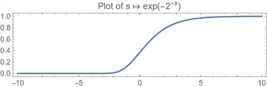

Long comment. Substituting $x = \exp(-2^{-s})$, $s \in \mathbb{R}$, we get
$$ \sum_{k=1}^{\infty} x^{2^k} = \sum_{k=1}^{\infty} \exp(-2^{k-s}). $$
Let $f(s)$ denote the sum above. By noting that the function $s \mapsto \exp(-2^{-s})$ behaves like a unit step function,
Plot of exp(-2^{-s})

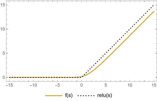

it is reasonable to expect $f(s)$ to behave like $\operatorname{relu}(x) := \max\{0, x\}$. Indeed, the graph below compares the graph of $f(s)$ with $\operatorname{relu}(s)$:
Comparison between f(s) and relu(s)
If we believe that $f'(s)$ is increasing (which seems true based on numerical experiments though I have no idea how to prove it now), we obtain a lower bound
$$ f(s) \geq \max\{0, s - C\}, $$
where $C$ is the constant defined by
\begin{align*} C &:= \lim_{s\to\infty} (s - f(s)) \\ &= \sum_{k=0}^{\infty} \left[ 1 - \exp(-2^{-k}) \right] - \sum_{k=1}^{\infty} \exp(-2^{k}) \\ &\approx 1.3327473824328992250\ldots \end{align*}
Plugging $s = -\log_2(-\log x)$, this lower bound becomes
$$ \sum_{k=1}^{\infty} x^{2^k} \geq \max\left\{0, -\frac{\log(-\log x)}{\log 2} - C \right\}, $$
which is actually tight as $ x \uparrow 1$.
