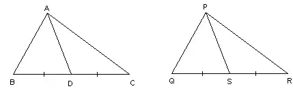

Given: AD & PS are medians in ΔABC and ΔPQR respectively,
$$\frac{AB}{PQ}=\frac{AD}{PS}=\frac{AC}{PR}$$
To Prove: ΔABC ~ ΔPQR
Figure:
Triangles Image
Problem: In ΔABD & ΔPQS or in ΔADC & ΔPSR or in ΔABC & ΔPQR, I have only found that only two sides are proportional but can't figure-out third thing to prove similarity.
Plz help me.
  • I would use the cosine law to prove that one of the angles at $A$ equals one of the angles at $P$ – Ross Millikan Jun 29 '11 at 04:34
  • @Ross: Its a 10th standard question and students don't know trignometry, any other way to prove... – Javed Akram Jun 29 '11 at 04:40
    Since D is the midpoint of BC and S the midpoint of QR, you know that BD = DC, QS = SR. So BD/QS = DC/SR ... – amWhy Jun 29 '11 at 04:50
    You have to use (somehow) the fact that BDC and QSR are straight lines ie that the angles at D (and angles at S) are supplementary. It is possible (easy) to create a configuration where the ratios are equal and QS = QR but QSR is not straight - so straightness is essential. – Mark Bennet Jun 29 '11 at 05:01

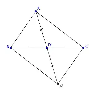

Create a point A' in the direction of AD, such that DA'=AD. Then there is a parallelogram ABA'C. So is parallelogram PQP'R.
Image made with Geogebra
And AD/PS=AA'/PP',
So, AB/PQ=AA'/PP'=AC/PR.
=>ΔABA' ~ ΔPQP'
=>∠BAD=∠QPS
So is ∠CAD=∠RPS
Then ∠BAC=∠QPR
=>ΔABC ~ ΔPQR
(Q.E.D.)
