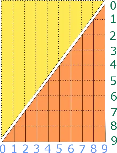

then we preserve everything from the right side exactly as it is. $$ \sum^{k}_{n=1}n=\frac{k(k+1)}{1 \cdot 2} $$
The following picture explains this sum:
Now again, preserve everything from the right side: $$ \sum^{k}_{n=1}\frac{n(n+1)}{1 \cdot 2}=\frac{k(k+1)(k+2)}{1 \cdot 2 \cdot 3} $$
