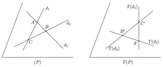

Let $(P)\subset\mathbb R^n$ be a 2-plane and the straight lines $d_1,d_2,d_3\subset(P)$ which intersect pairwise respectively at $A,B,C$. Since $T$ is bijective and $T(d_1),T(d_2),T(d_3)$ are straight lines, they intersect pairwise respectively at $T(A)=A',\,T(B)=B',\,T(C)=C'$. Hence they form a 2-plane $(A'B'C')$.
For each straight line $d\subset (P)$, if $d$ doesn't contain $A,B,C$ then $d$ must intersect with at least 2 lines of $d_1,d_2,d_3$ at at least 2 points. Since $T$ is bijective, so is $T(d)$. Hence, $T(d)\subset (A'B'C')$. We conclude $T(P)\subseteq(A'B'C')$. By a similar deduce, we show that $T^{-1}(A'B'C')\subseteq(P)$, therefore $T(P)=(A'B'C')$.

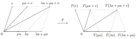

Let $\mu,\lambda\in\mathbb R\setminus\{0\}$ and $u,v\in \mathbb R^n\setminus\{0\}$ be linearly independent. Then $\{\mu u,v\},\, \{\lambda u,\mu u+v\},\, \{\lambda u+\mu u,v\}$ are also linearly independent. Thus, \begin{align} T(\lambda u)+T(\mu u)+T(v)\,&=\,T(\lambda u)+T\big(\mu u+v\big) \\ &=\,T\big(\lambda u+\mu u+v\big) \\ &=\,T\big(\lambda u+\mu u\big)+T(v),\tag1 \end{align} which implies $T\big(\lambda u+\mu u\big)=T(\lambda u)+T(\mu u)$. So, $T$ is additive.
