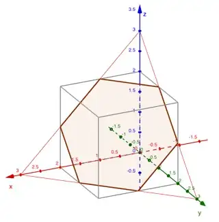

We want the solution to $x+y+z=3n$ subject to $0\leq x,y,z\leq 2n$.
The Hexagon in Question
The first equation is a planar equation in 3D space while the latter is a cube. Their intersection is the following regular hexagon:
Intersection in 3D Space
There are $n+1$ lattice points along each edge. We need to count the number of lattice points on this hexagon.

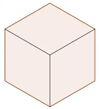

Now let's draw the centre of the hexagon, and connect three of its vertices to the centre. Do you see three sides of a cube in the following?
Hexagon Becomes Cube

  • Now I got it !! By looking at a corner of the cube along the body diagonal through that corner and taking the projection of the three faces meeting at the opposite corner, we see the regular hexagon as projection of three faces ; After removing $^3$ from an $(+1)^3$ we left with the three faces meeting at the opposite corner, and we can map their lattice points to the lattice points of the hexagon under discussion!! – Makar Jan 09 '24 at 19:57
