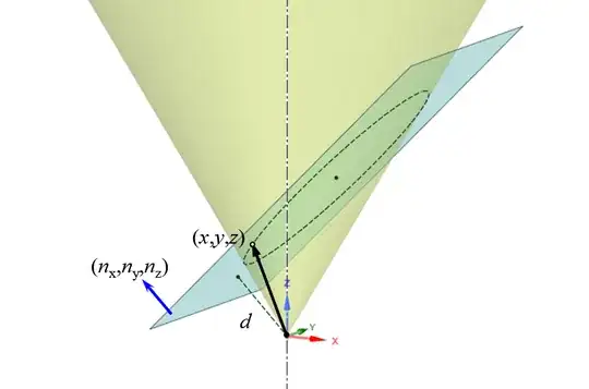

Given a 3D point $\boldsymbol{r}$, the equation of a cone with apex $\boldsymbol{a}$, unit direction vector $\boldsymbol{\hat g}$ and cone angle $\theta$ is
$$ \array{\text{cone: } & (\boldsymbol{r} - \boldsymbol{a})\cdot\boldsymbol{\hat g} = \| \boldsymbol{r} - \boldsymbol{a} \|\cos \tfrac{ \theta}{2} } \tag{1} $$
and the equation of a plane with unit normal direction $\boldsymbol{\hat n}$ and offset from origin $d$ is
$$ \array{\text{plane: } & \boldsymbol{r} \cdot \boldsymbol{\hat n} = d } \tag{2} $$
If you squared (1) you will transform it into its quadratic form
$$\left( (\boldsymbol{r} - \boldsymbol{a})\cdot\boldsymbol{\hat g} \right)^2 = (\boldsymbol{r} - \boldsymbol{a})\cdot(\boldsymbol{r} - \boldsymbol{a})\cos^2 \tfrac{ \theta}{2} \tag{3}$$
which contains terms with $x^2$, $y^2$, $z^2$, $x y$, $y z$, $z x$, $x$, $y$, $z$, and constants.
and if (2) is used to eliminate one of the coordinates, for example
$$z = \frac{d - n_x\; x - n_y\; y}{n_z}$$
then (3) is going to become a planar conic section in terms of $x^2$, $y^2$, $x y$, $x$, $y$, and constants.
Example
A cone along the z-axis intersects a plane as shown below
fig1

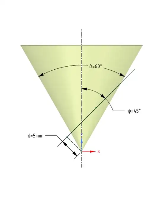

The dimensions are shown below
fig2
The equation of the cone is given by the dot product cosine rule
$$\begin{pmatrix}0\\ 0\\ 1 \end{pmatrix}\cdot\begin{pmatrix}x\\ y\\ z \end{pmatrix}=\left(\sqrt{x^{2}+y^{2}+z^{2}}\right)\cos\left(30°\right)$$
which when both sides are squared gives
$$ z^2 = (x^2+y^2+z^2) \tfrac{3}{4} $$
And the equation for the plane is
$$ \begin{pmatrix}\text{-}\sin45°\\ 0\\ \cos45° \end{pmatrix}\cdot\begin{pmatrix}x\\ y\\ z \end{pmatrix}=5 $$
which is simplified to
$$ \tfrac{\sqrt{2}}{2} (z-x) = 5 $$
and then
$$ z = x + 5 \sqrt{2} $$
which is used in the equation for the cone to produce
$$ ( x + 5 \sqrt{2} )^2 = \left(x^2+y^2+(x+5\sqrt{2})^2\right) \tfrac{3}{4}$$
and when all the terms are brought to one side
$$ \frac{x^2}{2} - \frac{5 \sqrt{2} x}{2} + \frac{3 y^2}{4} - \frac{25}{2} = 0 $$
which looks like an ellipse. But it is defined in the cartesian xyz space, and not on the 2D planar coordinates.
I found that the planar coordinates $(u,v)$ can be transformed to the cartezian space with
$$\begin{pmatrix}x\\ y\\ z \end{pmatrix}=\begin{pmatrix}u+\frac{5\sqrt{2}}{2}\\ v\\ u+\frac{15\sqrt{2}}{2} \end{pmatrix}$$
such that $(u,v)=(0,0)$ represents the center of the ellipse. The above obeys the plane equation and transforms the ellipse into
$$ \frac{u^2}{2} + \frac{3 v^2}{4} - \frac{75}{4} = 0 $$
The above is brought into the standard ellipse form of
$$ \left( \frac{u}{a} \right)^2 + \left( \frac{v}{b} \right)^2 =1$$ with the parameters $a = \frac{5 \sqrt{6}}{2}$ and $b = 5$.
