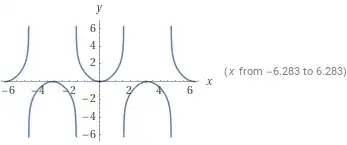

Now the best way to solve this equation is to look at the graph of $\sin\theta\operatorname{arsinh}\left(\tan\left({\theta}\right)\right))$, which is pictured below:

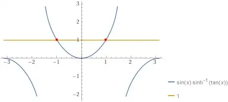

If we then drew the line $y=1$ across this graph, we would get the following:
Now, since $0 \leq \theta \leq \frac{\pi}{2}$, we will only be looking at the positive solution.
The positive solution is $\theta \approx 0.985515$ radians (to $6$ d.p.)
Multiplying this by $\frac{180}{\pi}$, the answer to this problem (in degrees) is approximately $\fbox{$56.46^{\circ}$}$ (to $2$ d.p.)
