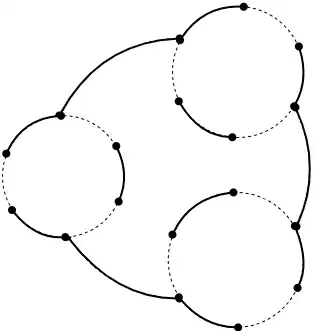

Consider the metric space embedded in $S^1$ with the intrinsic metric(the distance between two points is the length of the shortest arc connecting them):
$\hspace{3cm}$enter image description here

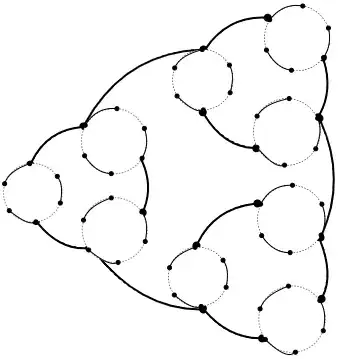

Notice there are $3$ 'gaps' in the circumference of the circle. We can fill each of these gaps with a smaller copy of this space, and continue like this recursively, below is a diagram of the second iteration in this process:
$\hspace{2cm}$ enter image description here

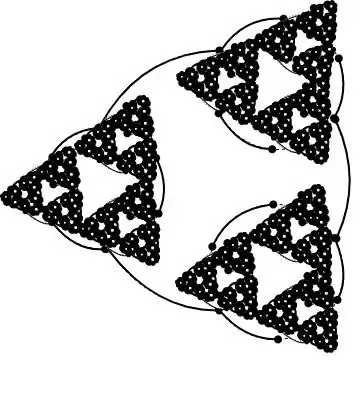

If we keep doing this on each, newly created gap, we obtain an ascending sequence of spaces, and we can thus take the union of all finite iterations such as the ones above. Call this space $\mathcal{U}$ (Which will look like a fractal). I am interested in properties of this space, which would look something like this (excuse the imprecision)
$\hspace{2cm}$enter image description here

  • @MW, to fill the gap, you scale the circle down so that its circumstance is $2/3$ (instead of $2$) and then after adding in the 3 copies, you identify the respective $(0,1)$ pairs, and then the distance between points on the smaller circles and the big circle is found by summing the distance to a point common on both. (I.e. it is again a subspace of some length space, the length space in this case being a circle with 3 of its segments replaced by smaller circles) – Carlyle Dec 24 '23 at 05:53
  • As an aside, I have tried to find a nice way to describe this process, but have failed, and hoped that it would be clear intuitively, but seeing as this is not the case, I would also appreciate suggestions on how to phrase this succinctly – Carlyle Dec 24 '23 at 05:54

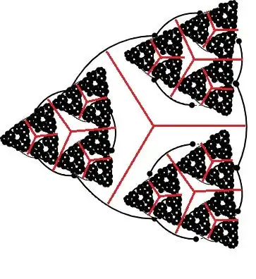

  • Now I do not follow. I admit I am not using intrinsic metric, but topologically it shouldn't matter. Here is a picture where your set does not intersect the union of the red line segments, and which I believe could be used to make your intuitive argument precise. It would also technically help to consider topological arcs instead of paths, where an arc is a path that has no self-intersections (never goes back to a point already visited). It is known that if two points are connected by a path, then they are also connected by a (topological) arc. – Mirko Dec 29 '23 at 16:53

I put this in a comment but the picture wouldn't properly render unless you click on it, so putting it here in an attempt at an answer that I may come back to later.
I admit I am not using intrinsic metric, but topologically (or even metrically?) it shouldn't matter. When you scale a circle down, it seems from the picture (inscribe a hexagon) that the diameter and the circumference decrease by a factor of $2$, not $3$ (though OP insist it is $3$, and I should take a more careful look). One could represent the set of centers of the circles, start at the origin, fix three vectors $u,v,w$ of equal length making $120^\circ$ angles pairwise (e.g. (minus) cube roots of $1$ in the complex plane), and consider finite sums $\displaystyle e_1+\frac{e_2}2+\frac{e_3}4+...+\frac{e_k}{2^{k−1}}$ where $e_i\in\{u,v,w\}$. Each such finite sum being a center, the radius decreases accordingly, three circular arcs are taken, right, top-left, bottom-left. (In the first picture further down, $u$ not shown but it goes from the center of the large circle to the center of the smaller circle on the left from the next iteration. The confusing "(minus)" above would disappear if one reflects the whole picture about the $y$-axis (which was done in the second picture further down)). In each connected triple of red line segments, the common point is the center of a circle, each of the three red segments being a radius, and three (closed) circular arcs from this circle go into the set, the other three (open) circular arcs do not (and I believe none of their points does, even at later stages, need to take a look)).
Where a path couldn't go, red line segments
It would also technically help to consider topological arcs instead of paths, where a (topological) arc is a path that has no self-intersections (never goes back to a point already visited). It is known that if two points are connected by a path, then they are also connected by a (topological) arc.
(Regarding a comment by Alex Ravsky which is a bit short so I may not follow what was meant to be said there, but if I do then: Aren't endpoints of circular arcs in the top-left path-component lying on a presumed "separating" line? Edit. I did reread that comment, it is about the construction with two gaps, instead of three, a different matter than what I was assuming, just looking at the pictures that go with three gaps. With two gaps indeed there would be a separating line (though I feel I need to see a picture to make sure how exactly the smaller arcs, that are added at each step, are joined to bigger arcs, e.g. at an endpoint or a midpoint of a smaller arcs). One could see some "trees" though in the construction with three gaps and perhaps try use them.)
Regarding the answer that is already posted I believe it is correct though I need to read it more carefully to understand some of the details. I tend to believe that the set is connected, even if not path-connected (this belief needs a proof, of course).
Edit. I read the comments by OP posted below, they are a bit over my head (not enough background on my part in algebraic/geometric topology, or differential geometry, whichever this belongs to) though perhaps I get some of the ideas, thank you. I seem to be interested in a different problem that also makes sense to me, like assuming these were honesty good pictures of a subset of the plane with the usual metric (that is what I took it to be on quick reading first). In this case the version with three gaps (instead of only two) seems just about right, an interesting problem. I may try ... to use some software to make a sketch in the plane (whether with a factor of 2 which I got used to, while staring at the pictures) or a factor of 3 (about which I need to think).

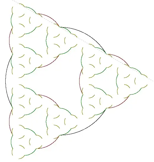

For what it is worth, here is a more precise picture of what I was "seeing" while looking at the pictures posted by OP. What is below is an honesty good embedding in the plane (with the usual metric inherited from the plane), that seems to parallel the picture posted by OP. First four levels are shown, along with a (dashed) line which "almost" appears to be separating, except that many endpoints of circular arcs of the "top-right" path-component lie on this line. (I reflected the previous picture (above, in this answer) about the $y$-axis since in my mind I think of certain finite sums involving ($\frac1{2^k}$ multiples of) vectors $u,v,w$ that correspond to the cube roots of $1$ in the complex plane. Each such finite sum is the center of a circle with appropriate radius.) Obviously the picture below closely parallels the construction by OP and perhaps could be employed in some useful way. (E.g. it looks like one could use it to illustrate the proof that the space in question is not path-connected.)
plane embedding, factor 2
(Credit to Ivan Johansen and his program "Graph" available at https://www.padowan.dk/ , used to make the above picture.)
