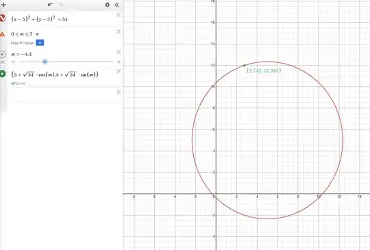

In general this seems tedious and hard. What I have done thus far is trying a simpler case, supposing that both $x$ and $y$ are $1$-digit numbers. Now their only digits are simply $x$ and $y$ respectively. This yields the following equation: $$x^2+y^2 = 10x+10y+4 .$$ After some algebraic manipulations we can rewrite the equation as the equation of a circle in the following way: $$(x-5)^2+(y-5)^2 = 54.$$
Now, I came to the conclusion that this equation does not have any natural numbered solutions just by eye-balling it in desmos. I guess you could do an exhaustive solution/proof by making a program in python for instance and just check for all $1$-digit $x$'s and $y$'s and come to the same conclusion.
