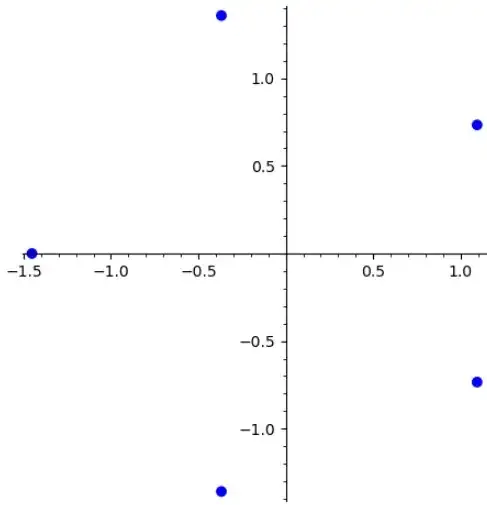

No, the pentagon formed by the roots of
$$x^5-x+5=0 \tag{1}$$
is neither regular nor centered in $0$ (one can be fooled by the fact that the axes haven't necessarily the same length if it is not explicitly asked).
One can check it on the approximate values of the roots, which are :
$$\begin{cases}r_1&\approx&-1.4519\\r_2&\approx&-0.36823+1.3592i\\r_3&=&\overline{r_2}\\r_4&\approx&1.0942 + 0.73443i\\r_5&=&\overline{r_4}\end{cases},$$
giving very different sidelengths, for example $\approx 1.73233$ between $r_1$ and $r_2$, and $\approx 2.18836$ between $r_4$ and $\overline{r_4}$.
It is not centered in $0$ because the norms of the $r_k, k=1,\cdots 5$ are :
$$\approx 1.4519, 1.4082, 1.4082, 1.3178, 1.3178$$
Edit : A rigorous proof, by contradiction, can be given. Let us assume that the pentagon is regular and centered in the origin : this would mean that the roots, now with indices $k=0,\cdots 4$ would be :
$$r_k=re^{ik \tfrac{2 \pi}{5}}$$
where $r=r_0\ne 0$ is the unique real root.
Their product, using one of the Viète's formulas, would give rise to :
$$r^5\underbrace{e^{i (0+1+2+3+4) \tfrac{2\pi}{5}}}_{= \ 1}=-5\tag{2}$$
Plugging (2) into the following relationship (true because $r$ is a root of equation (1)) :
$$r^5-r+5=0$$
leads to $r=0$ which is impossible.
As I know you are interested by Sage, here is the little program which has produced in particular the graphical representation :
CC=ComplexField(20)
p=x^5-x+5;
s=p.roots(ring=CC);
L=[];M=[];
for k in range(len(s)):
    m=s[k][0];
    L.append([m.real(),m.imag()]);
    M.append(abs(m));
print(L);
print(M);
Q=points(L,size=50);
show(Q,aspect_ratio=1);

  • Thank you again! It is very interesting to me that the roots do not form a regular pentagon, but how could we show it without approximations? Is there a way? –  Dec 14 '23 at 20:06
  • I just added a rigorous proof under the form of an Edit to my answer. – Jean Marie Dec 14 '23 at 21:51
