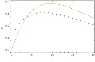

It turns out that the claim is false. For example, assume the common CDF $F(\cdot)$ of $X_i$'s takes the form
$$ F(t) = (1-p) (1 - (1-t)^m) + p t^m, \qquad 0 \leq t \leq 1$$
where $p \in (0, 1)$ and $m \geq 1$ are prescribed parameters. It is designed so that $X_i$'s approximately have Bernoulli distribution with parameter $p$ for $m$ large enough. So, if $\tilde{X}_i$'s are i.i.d. random variables having $\operatorname{Ber}(p)$ distribution, then
\begin{align*} \mu_n := \mathbb{E}[X_{(n)} - X_{(n-1)}] &\approx \mathbb{E}[\tilde{X}_{(n)} - \tilde{X}_{(n-1)}] \\ &= \mathbb{P}(\tilde{X}_{(n)} = 1 \text{ and } \tilde{X}_{(n-1)} = 0) \\ &= n p(1-p)^{n-1} =: \tilde{\mu}_n. \end{align*}
Since $\tilde{\mu}_n$ is not monotone in $n$, we can expect that the same is true for $\mu_n$ if $m$ is large. Indeed, below is the graph of $\mu_n$ (blue dots) and $\tilde{\mu}_n$ (orange dashed curve) corresponding to $m = 10$ and $p = \frac{1}{10}$:
