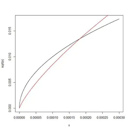

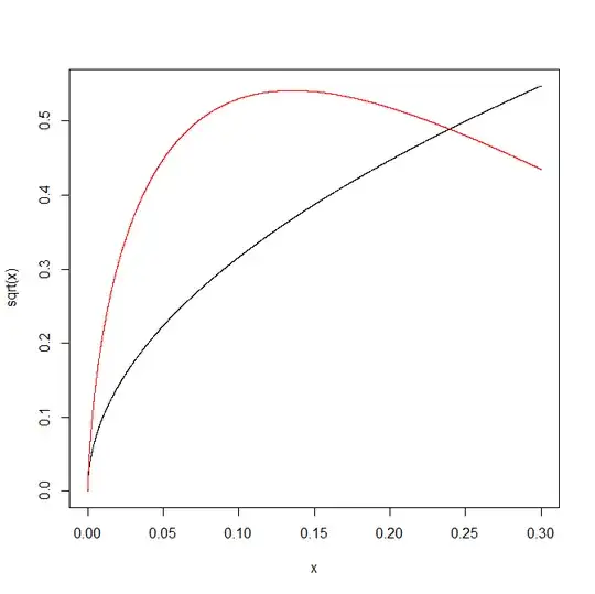

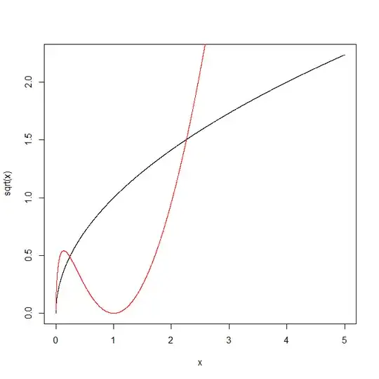

Here are three charts of $\sqrt{x}$ in black and $x(\log(x))^2$ in red over different ranges of $x$. You can see that for $x$ very small and positive, you have $x(\log(x))^2 < \sqrt{x}$, contrary to the assertion.
Looking at $x=e^{-n}$, you are comparing $n^2e^{-n}$ and $e^{-n/2}$, equivalent to comparing $n^4$ and $e^n$ and it should be easy to see that for $n \ge 9$ you have $n^4 < e^n$. This means that for $0 < x <e^{-9}\approx 0.0001234$ you have $x(\log(x))^2 < \sqrt{x}$.
You can improve that $e^{-9}\approx 0.0001234$ bound to about $0.000181697$ either numerically or using the Lambert W function as in $x = e^{4 W_{-1}(-1/4)}$, but you do not need to.
\sqrt{x} in black and x(\log(x))^2 in red
