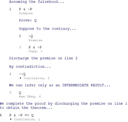

Does one accepted false statement allows proving anything?
Only as an intermediate result in a proof (see line 5 in example below). Note that a proof is not complete until every premise/assumption (lines 1 and 2 here) has been discharged.
Using a form of natural deduction, we can prove, for example, that $P \land \neg P \implies Q$ as follows:
(Screen shot)
It is not $Q$, but rather $P \land \neg P \implies Q$ that has been proven here to be a theorem of propositional logic. It tells us nothing about the truth value of $Q$.
(Text version of proof)
Assuming the falsehood...
1 P & ~P Premise
Prove: Q
Suppose to the contrary...
2   ~Q
    Premise
3   P & ~P
    Copy, 1
Discharge the premise on line 2
By contradiction...
4 ~~Q Conclusion, 2
We can infer only as an INTERMEDIATE RESULT...
5 Q Rem DNeg, 4
We complete the proof by discharging the premise on line 1 to obtain the theorem...
6 P & ~P => Q Conclusion, 1
