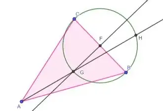

A construction that highlights the minimum area bounding square for any arbitrary triangle is here.
The construction sequence animation is here. The abbreviated construction sequence is:
Construct the perpendicular bisector of the side (BC) opposite the shared vertex (A).
Draw a circle centered on F with radius (BC)/2.
Find the intersection (G) of the perpendicular bisector with circle, that is nearest vertex A.
Draw a ray from A passing through G.
Find the second intersection of the ray and the circle that is outside the triangle (H).

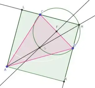

H is the second vertex of the bounding square. (A is the first).
Draw rays from H through the remaining vertices of the triangle.
Draw lines from A perpendicular to rays HL and HK.
I claim the smallest possible bounding minimal area square of the triangle is the square ALHK. I am looking for a proof (or counter-proof) that the algorithm outlined here does in fact produce the smallest bounding square of any given arbitrary triangle.
