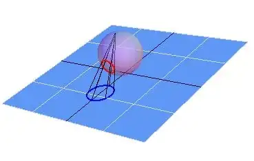

You can imagine a unit sphere sitting on the complex plane. A line on the complex plane, can be though of as a plane $X$'s intersection through the complex plane. $X$ is oriented such that it has to touch the top of our sphere. The intersection between $X$ and our sphere is the corresponding circle on the sphere.
A circle on the complex plane works the same way. Let us call a circle on the complex plane $Y$. All the points on $Y$ are connected the the top point of our sphere creating a curved plane that intersects our sphere and makes a circle. Perhaps this is also anther way of thinking of the line (and further shapes!).
A line being mapped to a circle:
A circle being mapped to a circle:
