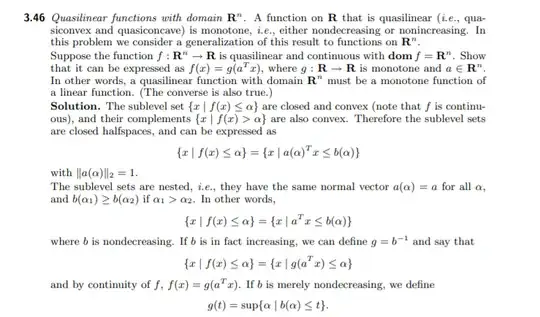

Reference. Boyd and Vandenberghe, "Convex optimization", page 122, Exercise 3.46;
http://web.stanford.edu/~boyd/cvxbook/bv_cvxbook.pdf
Since $F > 0$, $F$ and $1/F$ are both convex, we know that $F$ is continuous quasilinear.
According the reference, there is a monotone function $g: \mathbb{R} \to \mathbb{R}$ and $a \in \mathbb{R}^n$ such that $f(x) = g(a^T x)$.
The proof from the solution manual:
River Li
