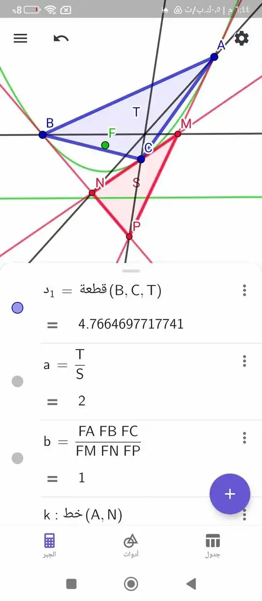

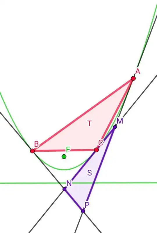

About ten days ago I discovered three beautiful properties of a parabola with three tangents drawn using the GeoGebra program. I would like to get proof of these properties and also know if any of them have been discovered before or not.
We have a parabola, and we chose three points from it, $A$, $B$, and $C$. We drew the tangents to the parabola in them, which enclose the triangle $∆MNP$, so the area of triangle ABC will be equal to twice the area of triangle $∆MNP$. In other words $T=2S$
Another beautiful property is achieved in the form: $\frac{FA×FB×FC}{FM×FN×FP}=1$

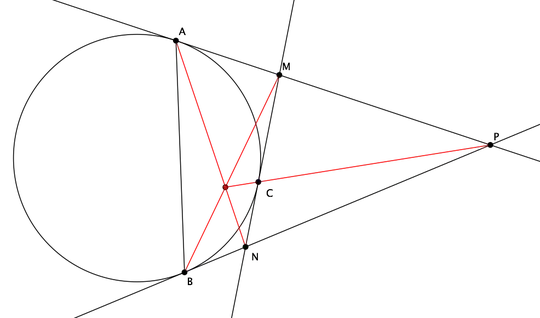

Also, the lines $AN$, $BM$, and $CP$ converge at one point
Let's prove the third property in the special case of a circle: as projective transformations preserve collinearity, the result holds for any conic section.
The proof follows from the converse of Ceva's theorem applied to triangle $PMN$: lines $PC$, $AN$, $BM$ concur if:
$$ {BN\over BP}\cdot{AP\over AM}\cdot{CM\over CN}=1. $$ But that is trivially true, because $$ BN=CN,\quad BP=AP,\quad AM=CM. $$
