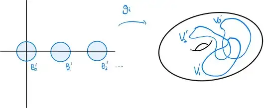

Maybe I found the proof. It seems true for some intuitive examples. I am just not sure if it holds for general(or weird) cases:
Let $M$ be a $C^1$ manifold with dim $k$ in $\Bbb{R}^n$. By Hubbard&Hubbard’s definition and the second countability of manifolds, There are countable many
  • open coordinate balls $B_{r_i}(0) \subseteq B_{r_i^\prime}(0) \subseteq \Bbb{R}^k$ with $0 < r_i < r_i^\prime$, abbreviated as $B_i$ and $B_i^\prime$.
  • and subsets $V_i \subseteq V_i^\prime \subseteq M$ covering $M$
  • and $C^1$ continuous maps $g_i: B_i^\prime \to V_i^\prime$ such that $g_i$ is one-to-one with $g_i(B_i) = V_i$, and the Jacobian matrix $Dg_i$ has rank $k$ at any points in $B_{r_i^\prime}(0)$.
Then spreading out the domains of all $B_i$ and $B_i^\prime$, in a way such that $B_i^\prime$ and $B_j^\prime$ are disjoint for all $i, j$, and for any $R > 0$, the ball $B_R(0)$ intersects only finitely many $B_i^\prime$. More precisely, let $R_i = 4\sum r_i$, and translate $B_i^\prime$ between $B_{R_i}(0)\backslash B_{R_{i-1}}(0)$, illuminated as follow:
![Untitled](Relax%20parametrization%20of%20manifold%2094c5af09bf8a413f9f002c0e405137e2/Untitled.png)

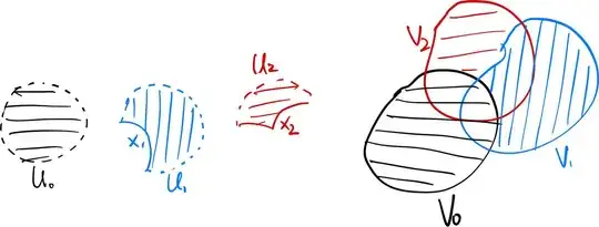

Then doctoring up these $g_i$ such that their codomains are disjoint in the following way: first let $U_0 = B_0$ and $X_0 = \varnothing$, then inductively define
$$ U_i = B_i\backslash \cup_{j < i} g_i^{-1}(V_i \backslash g_j(\overline{B_j})) $$
and
$$ X_i = B_i\cap\cup_{j < i} g_i^{-1}(V_i \cap g_j(\partial B_j)) $$
![Untitled](Relax%20parametrization%20of%20manifold%2094c5af09bf8a413f9f002c0e405137e2/Untitled%201.png)
Take $X = \cup X_i$ and $U = X \cup U_i$ and define the parametrization $\gamma: U \to M$ taking any point $x$ in $U_i \cup X_i$ to $g_i(x)$, then:
  • $U$ has boundary with $k$ dimension volume $0$ because it’s boundary is $X = \cup X_i$: For any $R > 0$, the intersection $B_R(0) \cap X$ is a finite union of dim $k-1$ manifold. (Here the Jordan content is used, and hence only the finite additivity holds)
  • $\gamma(U) = M$ for $\{V_i\}$ covers $M$
  • $\gamma|_{U-X}$ same as the union of $g_i|_{U_i}$ and hence one-to-one and $C^1$
  • the Jacobian $D\gamma$ is one-to-one because $Dg_i$ is one-to-one (rank $k$)
  • $X$ is same as $\partial U$ and hence $k$ dimension volume $0$. Given any $C\subseteq M$ compact, $C$ can be covered by finitely many $V_i$. Hence $\gamma(X) \cap C$ is the union of finitely many $\gamma(X_i) \cap C$ and hence with dim $k$ volume $0$ (also used the finite additivity of Jordan content here, and with $\gamma(X)$ a union of dim $k-1$ manifolds).
