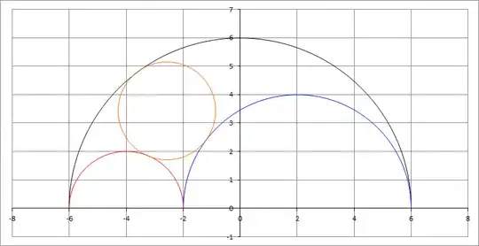

Three semi-circles have their centers as follows: $(0,0), (2, 0), (-4, 0)$ with radii of $6, 4, 2$, respectively. Determine the radius and center coordinates of a circle that is tangent to all three semi-circles.
My attempt:
Let $C_1 = (x_1, y_1) = (0,0), C_2 = (x_2, y_2)= (2, 0), C_3 = (x_3,y_3) = (-4, 0) $ and let $r_1 = 6 , r_2 = 4, r_3 = 2 $.
Further, let $C_4 = (x_4, y_4)$ be the center of the required circle, and $r_4$ be its radius, then by connecting the centers of the fourth circle with each of the first three, we can write the following three quadratic equations:
$ (x_4 - x_1)^2 + (y_4 - y_1)^2 = (r_1 - r_4)^2 $
$ (x_4 - x_2)^2 + (y_4 - y_2)^2 = (r_2 + r_4) ^ 2$
$ (x_4 - x_3) ^ 2 + (y_4 - y_3) ^ 2 = (r_3 + r_4) ^ 2 $
My question is, how to solve these three equations for the unknowns $x_4, y_4, r_4$?

As @intelligentipauca suggested, I started by subtracting the second equation from the first, this gives
$x_4 (-2 x_1 + 2 x_2 ) + y_4 (- 2 y_1 + 2 y_2 ) + x_1^2 - x_2^2 + y_1^2 - y_2^2 = r_4 (- 2 r_1 - 2 r_2 ) + r_1^2 - r_2^2 $
And similarly, subtracting the third equation from the first equation gives
$x_4 (-2 x_1 + 2 x_3 ) + y_4 (- 2 y_1 + 2 y_3 ) + x_1^2 - x_3^2 + y_1^2 - y_3^2 = r_4 (- 2 r_1 - 2 r_3 ) + r_1^2 - r_3^2 $
Now we have a linear system of two equations in $3$ unknowns.
The system can be expressed as follows
$ A X = B $
where $X = [x_4, y_4, r_4]^T $
and
$A = \begin{bmatrix}-2 x_1 + 2 x_2 && - 2 y_1 + 2 y_2 && 2 r_1 + 2 r_2 \\ -2 x_1 + 2 x_3 && - 2 y_1 + 2 y_3 &&2 r_1+ 2 r_3\end{bmatrix} $
and
$B = \begin{bmatrix} -x_1^2 + x_2^2 - y_1^2 + y_2^2 + r_1^2 - r_2^2 \\ -x_1^2 + x_3^2 - y_1^2 + y_3^2 + r_1^2 - r_3^2 \end{bmatrix}$
Plugging the given values of $x_1, x_2, x_3, y_1, y_2, y_3, r_1, r_2, r_3 $, gives us
$A = \begin{bmatrix} 4 && 0 && 20 \\ -8 && 0 && 16 \end{bmatrix} $
$ B = \begin{bmatrix} 24 \\ 48 \end{bmatrix} $
The solution of which is
$ X = \dfrac{1}{7} \begin{bmatrix} -18 \\ 0 \\ 12 \end{bmatrix} + \lambda \begin{bmatrix} 0 \\ 1 \\ 0 \end{bmatrix} $
So that,
$ C_4 = \dfrac{1}{7} \begin{bmatrix} -18 \\ 0 \end{bmatrix} + \lambda \begin{bmatrix} 0 \\ 1 \end{bmatrix} $
And
$ r_4 = \dfrac{12}{7} $
Pluggin these into
$ (C_4 - C_1)^T (C_4 - C_1) = (r_1 - r_4)^2 $
Gives
$ \lambda = \dfrac{24}{7} $
So that
$ C_4 = \dfrac{1}{7} \begin{bmatrix} -18 \\ 24 \end{bmatrix} $
