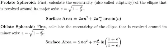

  • See also my older post for spheroids here.

  • It is interesting that you give these closed form formulas for this particular cases, but you should warn the asker that we are here in the general case where the ellipsoids are neither prolate nor oblate ... Btw : in the case of prolate or oblate ellipsoids, could the formulas you give be explained using the ¨Pappus-Guldin theorem ? – Jean Marie Oct 20 '23 at 05:19
