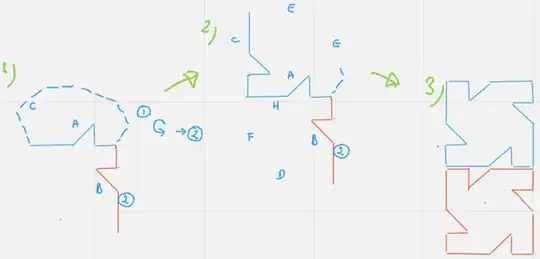

Since no-one has tried an answer yet here goes...
It's to do with whether it's possible for one polygon to be rotated to make the other e.g. by 90 degrees, but not 180 degrees.
In diagram 1) region A is the join of the two polygons
If we have polygon 1 rotated to make polygon 2, we have region B. Since the entire polygon has rotational symmetry order 2, we have region C as a copy of region A and B...diagram 2)
then we get region D, since polygon 2 is a rotation of 1, then region E due to the rotational symmetry of the entire polygon etc... leading to diagram 3

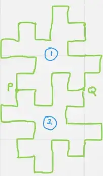

This would not be allowed, since there are gaps along the join. It could be argued however that the join could be designed to eliminate any gaps or overlaps by making the join rotationally symmetric, order 2 like this
But this makes the two polygons rotations of each other with a 180 degree rotation. So if this reasoning is correct, it doesn't seem possible for the second polygon to be a rotation of the first by 90 degrees.

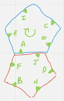

Extension: The same kind of argument seems to apply for other rotations and part rotations, an inward pointing region at A is reproduced at B, by a 36 degree rotation, then C due to the 180 rotational symmetry of the whole shape, then D by a 36 degree rotation etc...
Starting with A, we end up with A and J at the join, requiring the join to be rotationally symmetric (order 2) making the red polygon a rotation, by 180 degrees of the first, so far it's looking as though the answer to your question is 'yes'.
