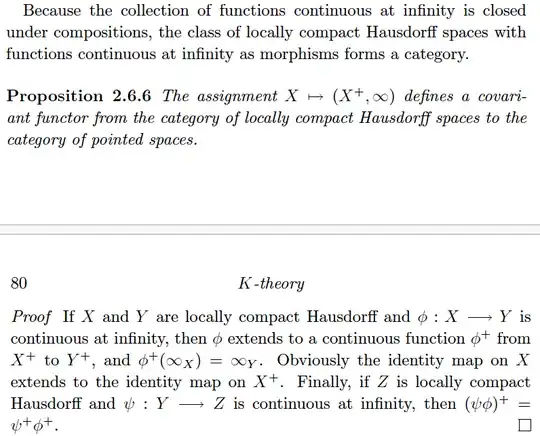

My question concerns the passage below: Why does continuity at infinity of $\phi$ imply that the extension $\phi^{+}$ to the one-point compactifications necessarily maps $\infty_{X}$ to $\infty_{Y}$? (NB A continuous map between locally compact Hausdorff spaces is continuous at infinity if it extends to a continuous map between their one-point compactifications.) For instance, the constant map $c_{0}\colon \mathbb{R} \to \mathbb{R}$ taking the value $0$ at all real numbers is continuous at infinity, but I believe its extension $c_{0}^{+}$ must map $\infty_{\mathbb{R}}$ also to $0$.
Page 80 of Park

    Are you sure about the definition of continuous at infinity is correct? The usual statement is about proper maps. – ronno Oct 12 '23 at 08:55
  • You should give us the complete definition of "continuity at infinity " in Park's book. If it is that in your question, then the Proposition is wrong. See my answer to https://math.stackexchange.com/q/4278155. – Paul Frost Oct 12 '23 at 10:31
    I looked at the book, and I too am confused: in the passages immediately preceding the screenshot, the author defines continuous at infinity as in the question, proves that proper maps are continuous at infinity and points at an exercise about finding a map that is continuous at infinity but not proper, – ronno Oct 12 '23 at 11:24
  • @PaulFrost I have appended the definition in the text. – destine Oct 12 '23 at 15:58
Based on Definition 2.6.2 the Proposition is false if the morphisms of the category of locally compact Hausdorff spaces are understood as the maps which are continuous at infinity.
There are two ways to correct it:
  1. The assignment $X \mapsto X^+$ defines a covariant functor from the category of locally compact Hausdorff spaces and maps which are continuous at infinity to the category of compact Hausdorff spaces.
Here no basepoints are involved, one does not require that the extension $\phi^+$ of $\phi : X \to Y$ satisfies $\phi^+(\infty_X) = \infty_Y$.
  1. The assignment $X \mapsto (X^+,\infty_X)$ defines a covariant functor from the category of locally compact Hausdorff spaces and proper maps to the category of pointed compact Hausdorff spaces.
See Is one point compactification functorial?
The problem with the orginal Proposition is that there are maps which are continuous at infinity but not proper (for example constant maps), though of course proper maps are continuous at infinity.
Remark.
The author's intention is to extend a map $\phi : X \to Y$ to a continuous $\phi^+ : X^+ \to Y^+$ such that $\phi^+(\infty_X) = \infty_Y$. This works if and only if $\phi$ is proper.
Note that if $X$ is compact, then all maps $\phi : X \to Y$ are proper and thus can be extended via $\phi^+(\infty_X) = \infty_Y$. However, in this case there are more continuous extensions of $\phi$. In fact, $\infty_X$ (which ís an isolated point of $X^+$) can be mapped to any $y \in Y$. But these additional extensions are irrelevant for the purpose of finding a functor.
In 1. the only case in which $\phi^+(\infty_X) = \infty_Y$ cannot be achieved is when $\phi$ is continuous at infinity, but not proper. Here we have $\phi^+(\infty_X) \in Y$. Recall that for compact $X$ there are no non-proper $\phi$.
