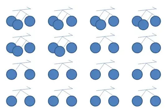

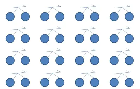

74
Robert Israel's solution is (I believe) best suited towards an elementary school student if it is graphical:
  1. Sketch out 16 bicycles. Count the wheels. There are 32 wheels:
  1. Start adding wheels to make tricycles until you have 38 wheels (i.e., every time you add a wheel, count up from 32). Count the number of tricycles and bicycles. Now you know there are six trikes and ten bikes:

    :) and that's the graphical way to show what I answered and was "it's not different from Robert Israel answer"... graphical are always a good way to start – woliveirajr Aug 29 '13 at 13:05
  • methods like this are good for understanding patterns and developing a method to solve the problem, but If you don't do it in a small scale and adjust to larger numbers then you wont really learn anything about the math. – Grady Player Aug 29 '13 at 19:32
  • This is a brilliant way of showing the answer without using algebra, but I think it requires too much up-front brilliance to come up with this answer when starting with a blank sheet of paper. – Mark Lakata Aug 29 '13 at 20:42
    @MarkLakata I think it could be used as one of those examples to show young students that a good tool to have in your problem-solving toolbox is to try to sketch out a solution. I would start out by saying, "hey, what if everyone had bicycles?" Then, "what if this kid had a tricycle? How many wheels are there now?" – Chris Gregg Aug 30 '13 at 02:12

10 bicycles X 2 wheels = 20 wheels 6 tricycles x 3 wheels = 18 wheels
Number of students multiplied by the number of tricycle wheels minus the total number of wheels equals the number of bicycles.
