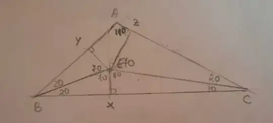

Let the triangle $ABC$ be $\angle A = 110°$ and $\angle B = 40°$. We consider a point $E$ inside the triangle $ABC$ so that $\angle ECB = 10°$ and $\angle EBC=20°$. Show that $CA=CE$.
my drawing
My ideas
We can show that $\angle C= 30$.
I observed that $BE$ is the bisector of $\angle B$ and I thought of the propriety of the bisector points so I drew some perpendicular from $E$ on the $3$ sides of the triangle. We can see that $EY$ and $EX$ are congruent. The fact that we have some $30$ angles makes me think of the theorem of the $30$ angle.
$AZEY$ is an inscribed quadrilateral.
I don't know what to do further. Hope one of you can help me! Thank you!

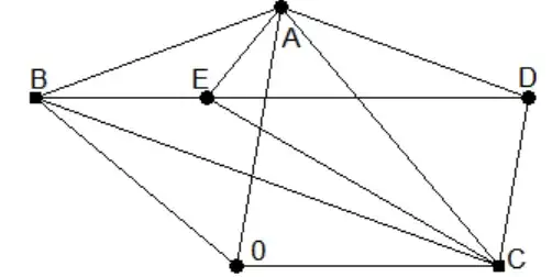

A different approach: Take D on (BE|BD=BC, then $\widehat{BDC}=80^\circ$ and we want DA=AB. Take now O the circumcenter of $\triangle ABC$, then $\triangle BOC$ is isosceles with vertex $\widehat{BOC}=140^\circ$, and by symmetry congruent to $\triangle DAB$, so $\widehat{ADB}=\widehat{DBA}=20^\circ$; with $\widehat{ACE}=20^\circ$, AECD is cyclic, $\widehat{EAC}=\widehat{BDC}=80^\circ,\triangle ECA$ is isosceles, $CE=CA$, done
