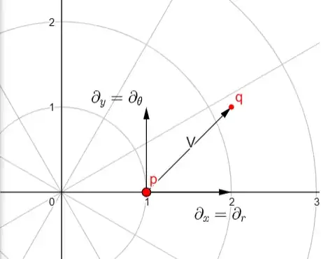

  • The Cartesian point $\color{red}p=(1,0)$ has polar coordinates $(r,\theta)=(1;0)$ where I am using the coloring and notation from this highly recommended answer. Thus, the Jacobian in (3) at this $\color{red}p$ is indeed $$\begin{pmatrix}1&0\\0&1\end{pmatrix}\,.$$ Congrats!
  • The vector $\boldsymbol{V}=\partial_x+\partial_y$ that points at this $\color{red}p$ into the Cartesian direction $(1,1)$ has polar components $(V^r;V^\theta)=(1;1)\,.$ I admit that this may look confusing but lets keep struggling.
  • This vector points from $\color{red}p$ to $\color{red}q=(2,1)=(\sqrt{5};\arctan(1/2))\,.$ Now you can use plotting of polar vectors in Geogebra to convince yourself that nothing is wrong.
  • The reason for $\boldsymbol{V}_{\color{red}p}$ having identical components in both coordinate systems is that at $\color{red}p$ the basis vectors happen to coincide which is not that puzzling when one thinks about it.

  • Thank you for your patience. I think all I need is an example of the calculation in (3), as that is where I'm getting stuck. For example if there is an (x,y) vector (1,1) at (1,0) then by my calculations using (3) I get the Jacobian in (3) as the 2x2 identity matrix do that the transformed polar vector is simply (1,1), and I'm sure that isn't right. Please, I just want an example calculation with actual numbers so that I can see where my misunderstanding is? – Lewis Kirby Sep 21 '23 at 22:35
  • Aha! Thanks again for your patience. I can now see that my mistake was getting to a certain point in the calculations and then suddenly abandoning mathematical reasoning and falling back on (faulty) intuition. When I found the polar vector was (1;1) I thought that the components were referring to r=1, theta=1, and that didn't make sense. I now see that the (1;1) are just the multipliers for the polar basis vectors (of course!). If that is correct, I'll be making this as the answer. Thanks again. – Lewis Kirby Sep 22 '23 at 06:55
  • Yes correct. I just happened to make an edit that clarifies this further. – Kurt G. Sep 22 '23 at 07:00
  • Brilliant, thanks again. Marked as answer. – Lewis Kirby Sep 22 '23 at 13:14
