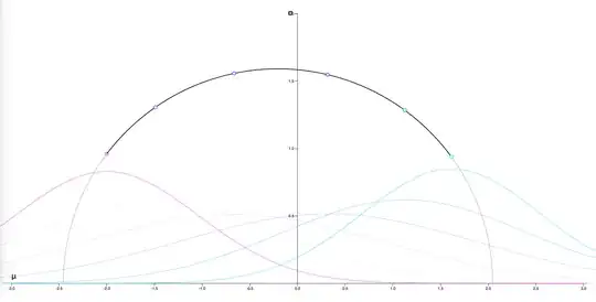

However, given that I'm using the Fisher metric as the metric tensor, I would expect that a geodesic of a univariate gaussian to follow an arc (e.g. shortest path between two univariate gaussian distributions is not a straight line as shown here). However, after optimizing the curve to minimize the energy, I'm always getting a straight line as distance between two univariate gaussians (using the same start/end points of the linked article from geomstats). Am I missing something ?

I have 2 parameters (mean, scale), and as you can see, the metric depends only on the scale. These parameters are parametrizing a univariate gaussian distribution (w/ mean and scale), and it is known that this metric induces an hyperbolic geometry (you can understand this better by looking at this animation, just click and drag and you will see the curve geodesic in the parameter space).
(note that y is my scale and x is mean, the dark black arc line is the geodesic, but this is not what I'm getting)
Now, if I minimize $E(\gamma)$ (using gradient descent) to optimize the curve parameters, what I get is a straight line connecting the parameters in the parameter space, while I would expect it to be curved as induced by the metric tensor.

  • Thanks, but it seems the problem is the same with this metric as well. I'm pretty sure the metric seems to be the issue because if I use a simple squared distance to origin (https://github.com/MachineLearningLifeScience/stochman/tree/master#stochmanmanifold-interface-for-working-with-riemannian-manifolds) it starts to show curved geodesics. – Tarantula Sep 21 '23 at 18:39
  • @Tarantula If you get horizontal lines as geodesics, there's something wrong with computing the geodesics. You can try plugging in the Poincare metric, $diag(1/y^2,1/y^2)$ for coordinates $(x,y)$, which should give you hyperbolic geometry. – Einar Rødland Sep 22 '23 at 05:47
  • I will check with the Poincare metric to see what happens. I was wondering if that could be related to multiple minima in the energy minimization, but not sure. However I do get curved geometry if I use the metric I mentioned earlier (square distance), that's why I think the metric is the issue. – Tarantula Sep 22 '23 at 09:16
