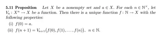

I am really baffled as to how to even start. It's obviously true, but I need to prove it using the recursion theorem of set theory (Amann and Escher's Proposition 5.11). I understand how the standard sum notation ought to interpreted. I've written:

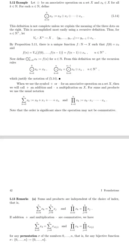

We must first interpret the notation $\sum_{j=0}^n x_{\sigma(j)}$. Given the definition for general associative operations in Example 5.12, one is led to presume that this notation refers to a recursive definition which is induced by the original. The original $\sum_{j=0}^n x_j$ is technically defined by Prop 5.11 in terms of some sequence $x_0,x_1,x_2,...$ in $X$ and some sequence of functions $V_n: X^n \to X, (y_0,...,y_{n-1}) \mapsto y_{n-1} + x_n$ for $n \in \mathbb{N}^\times$. Now take the unique function $f: \mathbb{N} \to X$ (by Prop 5.11) for which $f(0) = x_0$ and for all $n \in \mathbb{N}$, $f(n+1) = V_{n+1}(f(0),...,f(n)) = f(n) + x_{n+1}$. Then define $\sum_{j=0}^n x_j := f(n)$.
I am guessing that I need to interpret the notation $\sum_{j=0}^n x_{\sigma(j)}$ somehow in terms of a recursive definition related to the sequence $V_n$ which defined $\sum_{j=0}^n x_j$ (and then perhaps I need to use induction somehow?), but I can't see how given that $\sigma$ is defined for fixed $n$, among other things. Can anyone provide a hint or even a sketch of a proof, with careful attention paid to what $\sum_{j=0}^n x_{\sigma(j)}$ really means?
For those interested in all the gory details of what I have, I have attached a couple pictures of relevance, but hopefully my question is valid as it stands. enter image description here enter image description here

The proposition 5.11 that you cited from your book is actually a very shoddy one from a logical viewpoint. It has the nebulous ellipsis ("..."), which in general is imprecise and results in shoddy conceptual understanding. The real general recursion theorem is:

  • For instance, I can convince myself of why $f$ exists by Prop 5.11, because I can define (given the fixed sequence $x$) the sequence of functions $V_n: X^n \to X, , (y_0,...,y_{n-1}) \mapsto y_{n-1} + x_n$. With this sequence and $a = x_0$ fixed, $f$ is now well-defined. But I can't see how we would do this so as to define $f_\sigma $ likewise by this recursion theorem. For fixed $n$, would you fix the sequence as $V^\sigma_m: X^m \to X, , (y_0,...,y_{m-1}) \mapsto y_{m-1} + x_{\sigma(m)}$ for all $m \leq n$, and then make an arbitrary assignment for $m > n$ since we don't care about those? – EE18 Sep 20 '23 at 13:18
