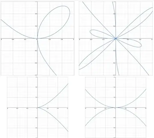

These are some of the ways a (real) plane algebraic curve can be singular at the origin:
enter image description here (The top left example is actually the present curve).

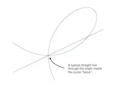

To find the different tangents, we can write $x=at$ and $y=bt$. This describes a straight line through the origin as $t$ varies, and it's a bit better than writing $y=ax$ because then we would miss the vertical line.
Putting $(x,y)=(at,bt)$ in the equation we get
$(at)^3+(bt)^3-12(at)(bt)=0$
or
$t^2(a^3t+b^3t-12ab)=0$
First of all, no matter what $a$ and $b$ are (i.e. no matter what line we are thinking of), we see that $t=0$ is a double root of this equation, which means that every straight line through the origin meets our curve twice at the origin.
But, when $a=0$ or $b=0$ (but not both), the term $-12ab$ disappears and we get $t^3(a^3+b^3)=0$, and now $t=0$ is a triple root. That means that the lines $(x=t,y=0)$ and $(x=0,y=t)$ meet our curve not twice (as usual) but three times – and that extra multiplicity is, geometrically, a tangency. Instead of slicing right through, the line gently hugs the curve, touching it one extra time. enter image description here enter image description here
It's beautiful to see how an algebraic property (the degree $k$ of the factor $t^k$) faithfully captures the geometry.

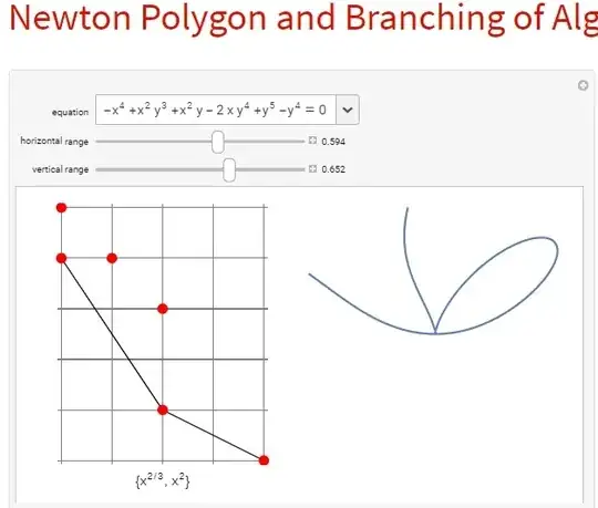

There is a very simple technique using the so-called Newton's polygon associated with the given polynomial in two variables :
The idea is first to associate the point $(n,p) \in \mathbb{N}^2$ to each monomial $ax^ny^p$ (coefficient $a$ isn't taken into account). For example, to the polynomial equation $13x^3y^2-5x^2y^2+5xy+7x=0$, the following points will be associated $(3,2), \ (2,2), \ (1,1), \ (1,0)$. In a second step, the convex hull is considered, and, for our purpose (being able to have all branches passing through the origin) considering only the lower part of the convex envelope as in the following example borrowed to this site. We see the behavior of the curve given by equation $-x^4+x^2y^3+\cdots = 0$ in the vicinity of the origin. On the right graphic, one sees two branches : one of them looks parabolic (think to $y=ax^2$), the other one looks "pinched", reminding, with a little habit, a local behavior of the form $y=ax^{p/q}$ (fractional exponent).
Now, the Newton polygonal is going to confirm our intuition.
Indee, the lower part of the convex hull is constituted by two line segments :
  • The first one joining $(0,4)$ to $(2,1)$ with slope $\color{red}{2/3}$ when looking the line at $90°$.
  • The second one joining $(2,1)$ to $(4,0)$ with slope $\color{red}{2}$.
These 2 slope values give the exponents we are looking for :
$$y=x^{\color{red}{2/3}} \ \text{in the first case and } \ y=x^{\color{red}{2}} \ \text{in the second case}$$
Moreover, there are exactly two different branches passing through the origin, therefore two tangents.
Up to you : check that it works on your polynomial !
I will not do any theory justifying this technique. You will find it, together with other uses of Newton's polygon for example on this site in certain questions/answers like this one.
