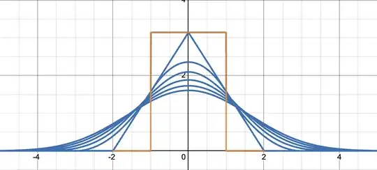

We're going to compute the general formula for $\widehat {f_n}(\omega)$. Note: Those Fourier transforms are known as box splines and are important in numerical analysis and interpolation. This is what they look like: enter image description here
Lemma: For $n\geq 1$, $$\widehat{f_n}(\omega)=\frac{\pi}{2^n (n-1)!}\sum_{k=0}^n {n \choose k} (-1)^k (\omega +n -2k)^{n-1} \text{sgn}(\omega +n -2k)$$ Proof: We proceed by induction.
For $n=1$, the formula reduces to $\pi$ times the indicator function of $[-1, 1]$, and you can verify that its inverse Fourier transform is $f_1$.
Suppose the formula is valid for some $n\geq 1$. Then, note that $f_{n+1}=f_1 f_{n}$. Thus, since the Fourier transform maps products to convolutions, we have $\widehat{f_{n+1}} = \frac 1 {2\pi} \cdot \widehat{f_1} \ast \widehat{f_n}$. This implies that $$\frac{d\widehat{f_{n+1}}}{d\omega} = \frac{d\widehat{f_{1}}}{d\omega} \ast \widehat{f_n} = \frac 1 2 \cdot (\delta_{-1} - \delta_{1}) \ast \widehat{f_n}$$ In other words, $$\frac{d\widehat{f_{n+1}}}{d\omega}=\frac{\widehat{f_n}(\omega+1)-\widehat{f_n}(\omega-1)}2$$ Thus, defining $g_n(x)=x^{n-1}\text{sgn}(x)$, $$\begin{split} \frac{d\widehat{f_{n+1}}}{d\omega} &= \frac 1 2 \cdot \frac{\pi}{2^n (n-1)!}\sum_{k=0}^n{n\choose k}(-1)^k g_n(\omega+n+1-2k)\\ &- \frac 1 2 \cdot \frac{\pi}{2^n (n-1)!}\sum_{k=0}^n{n\choose k}(-1)^k g_n(\omega+n+1-2k-2)\\ &=\frac 1 2 \cdot \frac{\pi}{2^n (n-1)!}\sum_{k=0}^n{n\choose k}(-1)^k g_n(\omega+n+1-2k)\\ &- \frac 1 2 \cdot \frac{\pi}{2^n (n-1)!}\sum_{k=1}^{n+1}{n\choose k-1}(-1)^{k+1} g_n(\omega+n+1-2k)\\ &= \frac 1 2 \cdot \frac{\pi}{2^n (n-1)!} \left[g_n(\omega +n+1) +(-1)^{n+1} g_n(\omega-n-1) +\\ \sum_{k=1}^{n}(-1)^k\left( {n\choose k} + {n\choose k-1}\right)g_n(\omega+n+1-2k)\right]\\ &= \frac 1 2 \cdot \frac{\pi}{2^n (n-1)!}\sum_{k=0}^{n+1}{n+1\choose k}(-1)^k g_n(\omega+n+1-2k) \end{split}$$ To prove the formula, we only need to integrate w.r.t. $\omega$, and use the fact that a primitive of $g_n(\omega)$ is $\frac {g_{n+1}(\omega)}n$. Note that the integration constant is $0$ as we expect the limit of $\widehat {f_{n+1}}$ at infinity to be zero (because it is the repeated convolution of $\widehat {f_1}$, which has a compact support).
$$\widehat{f_{n+1}}(\omega) = \frac 1 2 \cdot \frac{\pi}{2^n (n-1)!}\cdot \frac 1 n \sum_{k=0}^{n+1}{n+1\choose k}(-1)^k g_{n+1}(\omega+n+1-2k)$$
This concludes the proof of the lemma. To obtain the value of the integral, all that's left to do is to evaluate at $\omega=0$.
