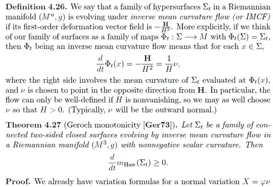

Edit. Let me present another piece of evidence that supports my question. The following is an excerpt from the book Geometric Relativity written by Dan A. Lee. Judging from the context, I find it really difficult to not believe that Theorem 4.27 talks about the image $\Sigma_t$ instead of $\Sigma$.

  • Thank you. If I go to Definition 4.26 in the edit with your view, would it suggest that both $H$ and $\nu$ are quantities pertaining to $(\Sigma,\Phi_t^*g)$? Here, according to Dan A. Lee, $\Sigma$ is a subset of $M$ and a hypersurface in $M$. – Boar Sep 11 '23 at 09:41
    Again, you’re asking the wrong question. I can always rephrase the theorem on either set. You just need to know what the smooth structure is, what the Riemannian metric is. – peek-a-boo Sep 11 '23 at 10:14
    The only warning I’ll give with immersions is they demand a willy wonka topology. Once you’re aware of this, you’re free to phrase things however you wish. – peek-a-boo Sep 11 '23 at 10:15
