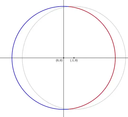

Sorry for the self-answer! Here is my explanation why the average distance at (0.1, 0) (or any point other than the origin) is greater than 1. diagram of circles centered at origin and also at (0.1,0)
Let $C$ be the unit circle centered at the origin. The picture has $C$ as the solid colored line, and the unit circle centered at (0.1,0) is the dashed line. The points on $C$ with distance less than 1 to (0.1,0) are colored red, the ones with distance more than 1 are blue. You can see there are more blue ones than red ones.
If we slide the point (0.1,0) further to the right, the red zone only shrinks (and eventually disappears entirely), so this average distance will always be greater than 1, increasing as our point moves further away from the origin.
