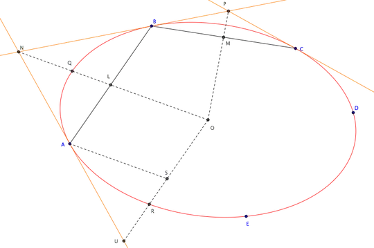

Let $ABCDE$ be the five given points, lying on the same plane. We can use Pascal's theorem to find the line tangent to the ellipse at $A$: if $F$ is the intersection of $AB$ with $CD$, and $G$ is the intersection of $AC$ with $BE$, then the intersection $T$ of $FG$ with $DE$ is a point on the tangent at $A$ to the conic $ABCDE$ (see here for a detailed proof). Repeat the same construction to find the tangents at points $B$ and $C$.
Let then $N$ be the intersection of the tangents at $A$ and $B$, $P$ the intersection of the tangents at $B$ and $C$. If $L$ and $M$ are the midpoints of segments $AB$ and $BC$, then the center $O$ of the ellipse is the intersection of lines $PM$ and $LN$ (this is due to a another well-wknon theorem: center, midpoint of a chord and intersection of the tangents at the endpoints of the chord are collinear).
Construct $Q$ on ray $ON$ such that $OQ=\sqrt{OL\cdot ON}$ (see figure below). Draw then ray $OU$ parallel to $AB$, meeting $AN$ at $U$; construct on it point $S$ such that $AS\parallel ON$ and point $R$ such that $OR=\sqrt{OS\cdot OU}$. Segments $OQ$ and $OR$ are a pair of conjugate diameters. If the conic is an ellipse, a parametric equation can be written as: $$ O+(Q-O)\cos t + (R-O)\sin t. $$
