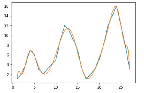

Here is a Python Jupyter script for that purpose.
If you can restrict yourself to polynomials, NumPy (a Python math library) will offer an easy solution:
import numpy as np
from numpy.polynomial import Polynomial as P
x = [1,2,3,4,5,6,7,8,9,10,11,12,13,14,15,16,17,18,19,20,21,22,23,24,25,26,27] y = [1,2,4,7,6,3,2,3,4,5,9,12,11,9,7,3,1,2,3,5,8,12,14,16,12,8,3]
plt.plot(x,y) # plot the original dataset
polynomial = P.fit(x, y, 14) # 14 is the degree of the polynomial fx, fy = p.linspace(100) # generate 100 sample points on this graph plt.plot(fx, fy) # plot the calculated polynomial
I am not sure whether this applies to your usecase, but restricting oneself to polynomials might not be as bad as it seems since most functions can be approximated with a Taylor series and compared to other functions, polynomials are usually easier to work with.
The provided code sample produces the following output (the blue line being the original dataset and the orange line being the calculated function):
