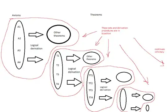

Does there exist a consistent theory (formal system) which has, say
  • a set of axioms $\{A_1,A_2,\dots, A_n\}$ + rules of inference
such that there is
  • a proper subset of (non-trivial) theorems $\{T_1,T_2, \dots,T_n\}$
which if taken themselves as axioms with the same rules would reproduce the whole theory itself?
In naive words: is there a consistent theory which contains "itself" as a part in a self-similar (like a fractal) manner?
Is ZFC such a theory?enter image description here
  • What is "self-similar" about this? Lots of theories admit multiple different axiomatizations. – Qiaochu Yuan Aug 22 '23 at 03:14
  • @QiaochuYuan Let me put it more simply, is there a theory which can be constructed inside itself in a non-trivial manner? Can we construct ZFC theory as a proper subset of ZFC theory itself? – Sergey Dylda Aug 22 '23 at 03:37
  • This is completely dependent on the choice of axiomatization of the theory. Some axiomatizations of ZFC - including the usual one - are redundant, and any theory has a redundant axiomatization (this is completely trivial - just add "$\varphi\wedge\varphi$" as an axiom where $\varphi$ is already an axiom); however, every theory has an irredundant axiomatization (see here). Does this answer your question? (I don't really see anything "fractal-like" about this.) – Noah Schweber Aug 22 '23 at 03:40
  • @NoahSchweber Your example about $\varphi \wedge \varphi$ is a nice one, but what I would call a "trivial case". I am sorry, I am not a logician I don't know how to described it in words more precisely. I've attached a picture to a post of what I have in mind. – Sergey Dylda Aug 22 '23 at 04:13
  • @bof ${T_1, \dots, T_n}$ is a proper subset of the set of all theorems derivable from axioms ${A_1, \dots A_n}$. Please look at the attached picture for example. – Sergey Dylda Aug 22 '23 at 04:29
