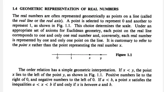

Consider this fact that we all know from school mathematics: There is a one to one correspondence between real numbers and points of a line. But the problem is I have never seen a rigorous proof of this fact.
apostol
This is what Apostol writes. And similar is the case with other modern analysis books.
So my question is, where can I find the proof of this one to one correspondence. I don't care if geometry is in Hilbert's axioms or Tarski's or anyone else all I care about is correspondence.

    What precise definitions are you using for "real numbers" and "line"? Personally I would take this as motivation for a choice of definition(s) rather than a technical result to be proved. That said, see the discussion here. – Noah Schweber Aug 14 '23 at 16:38
    What definition of "line" are you using? If that definition refers to an ambient space (such as "the points in a plane that satisfy..."), what definition of that ambient space are you using? – Greg Martin Aug 14 '23 at 16:38
  • Let real numbers be defined by fields +order +completeness axioms and line , point , betweeness and other geometric notions be axiomatically defined under any suitable axiom system (for example Hilbert's or Tarski's). Then prove this equivalence or correspondence – Priyanshu Kalal Aug 14 '23 at 16:42

You may find the following useful:
  1. The nlab page on euclidean geometry.
    Here they mention that a model of Tarski's axioms is a product of a real closed field with itself. And vice versa, any product with itself of a real closed field is a model of Tarski's axioms.
  2. An answer of math stackexchange that has a link to a paper with the proof.
Importantly, real closed fields are not the same as the real numbers.
The real numbers are a model, but by Löwenheim-Skolem you get models of other cardinalities. Therefore the equivalence you were looking for actually only goes one way if the question is interpreted this way.
Here's the nlab page on real closed fields with some extra examples.
I understand that when one reads "the real numbers are often represented geometrically as points on a line", it is meant that the plane $\mathbb R\times \mathbb R$ is a model.
Once that's fixed, you are in set theory and know how to talk about a line as a subset of $\mathbb R\times \mathbb R$, and it is easy to see it is in correspondence with $\mathbb R$. So in this sense you do have a correspondence, but only once you fix a nice enough model, and I believe that's what is meant by "under an appropiate set of axioms".
But there's room for interpretation.
